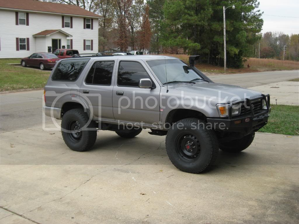

Here is what i am running on my diesel 4 Runner:
285/75/17 a true 34 by 11 with OEM FJ Cruiser steel wheels
2" ball joint spacers and OME springs and t bars
