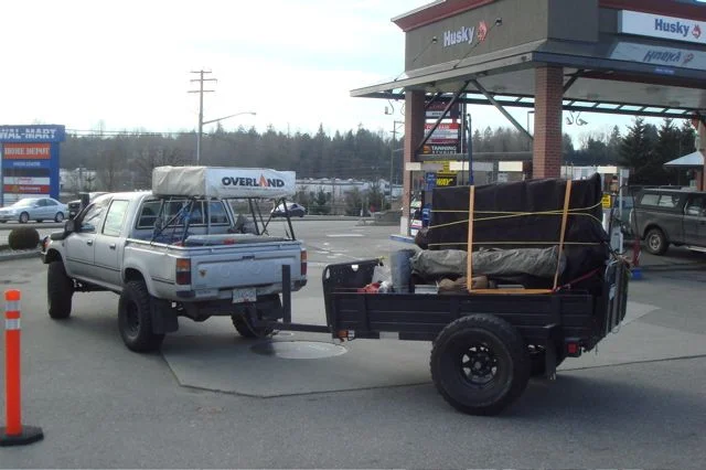

I stuck 33's on my Snowbear trailer a week or so ago and towed it 80 kilometres off-road with a load.
It still has the really really stiff factory springs but i aired down to about 6psi and for the most part it worked great.
The 33's can soak up allot of pot-holes ETC.
I had about six hundred pounds on the trailer.

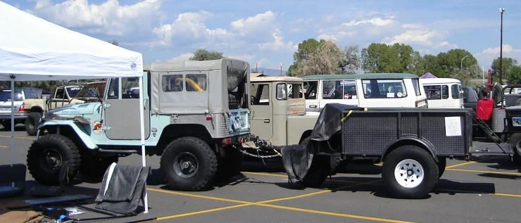

i've got 33's on mine. works great behind all my rigs. couldnt' match tire sizes to my rigs because all my rigs run different size tires. i usually tow it behind my 40 with 36s and it works beautifully.
along the lines as mace, mine has 1" square stock protruding from each corner on the sides for removable "tables".
here's the only halfway decent pic of it behind a rig
What kind of trailer is this? I like!
