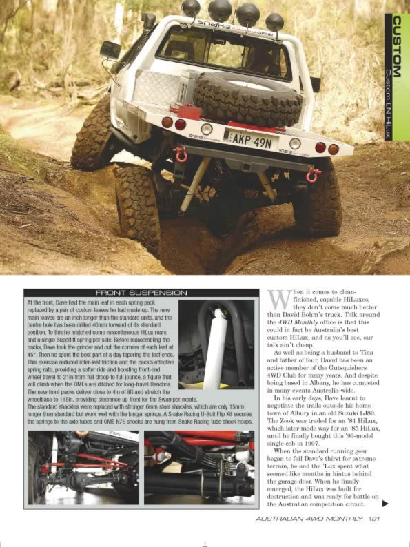

Missouriman, I am waiting to get some square/rectangle tubing in bulk so i can start my flatbed, and the sliders/cage will tie into it.
This what im looking to make,but add a roof rack, sliders, and limbrisers. I want more of an ARB "I will run you over" style bumper, but i want light weight so its still on the drawing board
