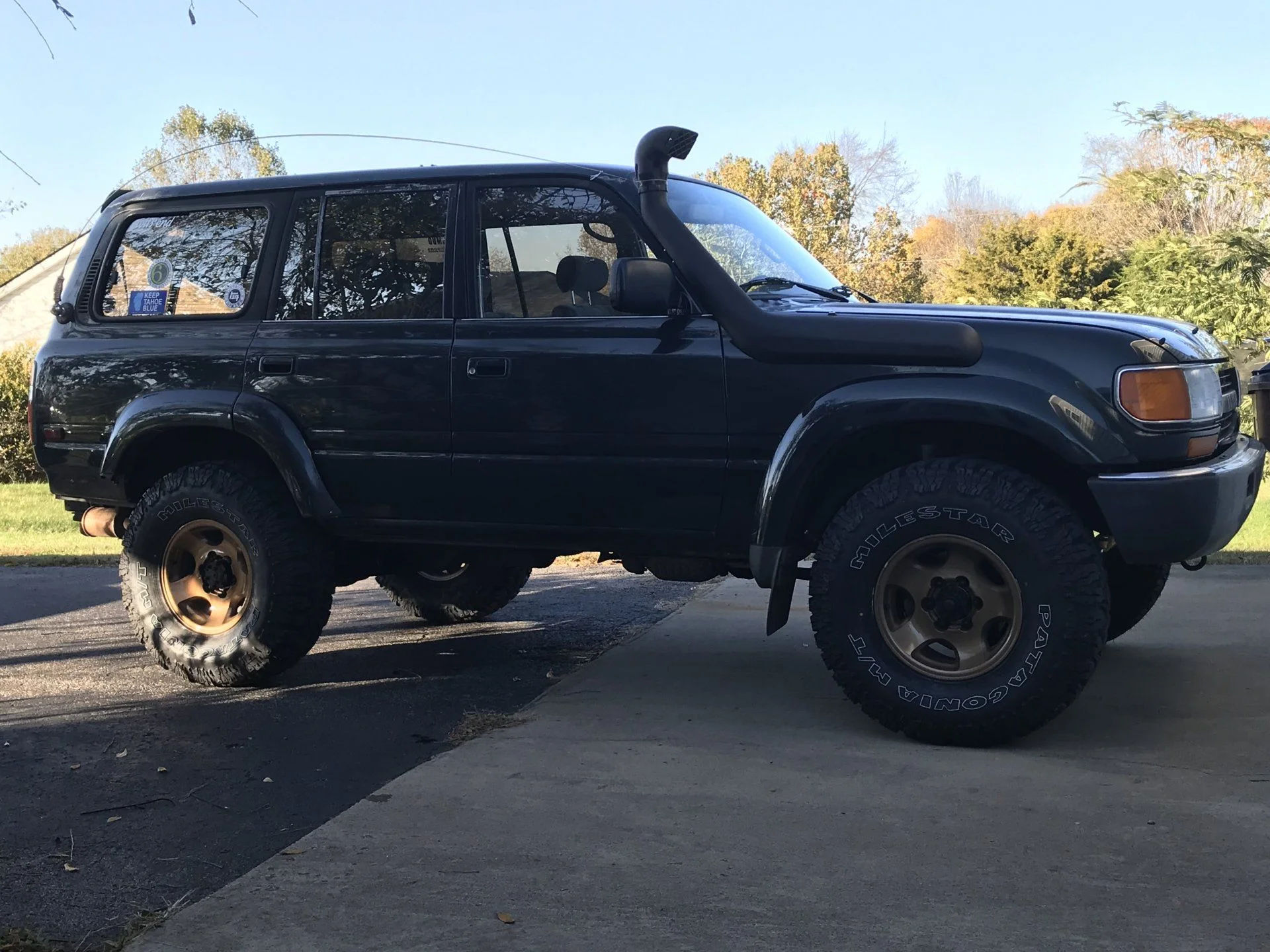

315-75-16 milestars and an iron man 3in lift that is old and saggy, not even close to rubbing anything with the tires. Pretty sure I could fit 37s if I used wheel spacers.

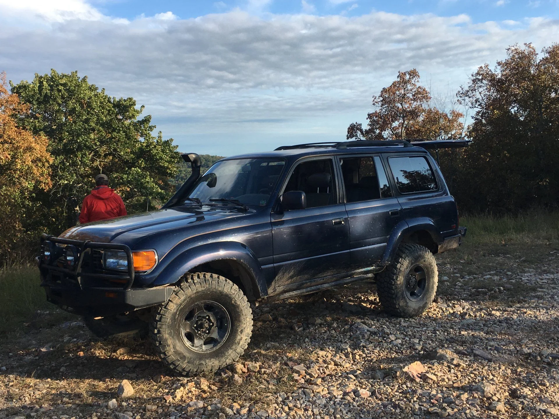

I'm running a 2 1/2 OME setup with 315's and they clear fine fully stuffed.... suspect a smaller 37" like the Ko2's would fit as well
They’ll rub. Three 80’s with three different suspensions ranging from 2-4” lift and all of them rub with 315’s. In fact, 315 BFG A/T KO2 which measure around 33.75 will rub. It’s minor enough that I no longer use bump stop drops. It takes a unique scenario to make it happen but it will indeed rub.
I can get my 315’s to rub. No bump drops, flares, OME medium, stock wheels. Full stuff rear rubs a touch, front at full lock and full stuff. That’s it.
