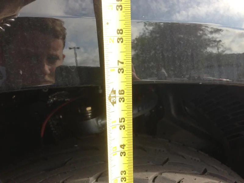

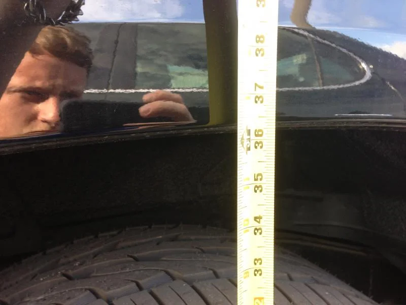

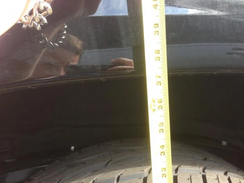

does anyone know if 305/50R20's will fit a 200 without a lift? i presume 1" lift if it is needed.

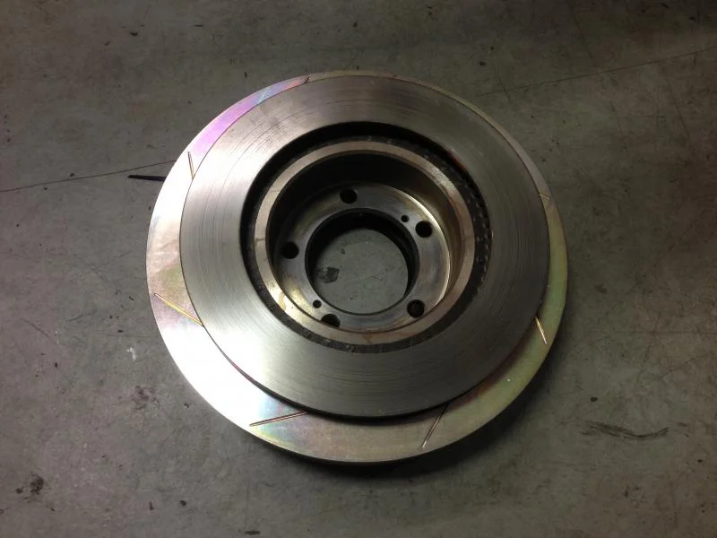

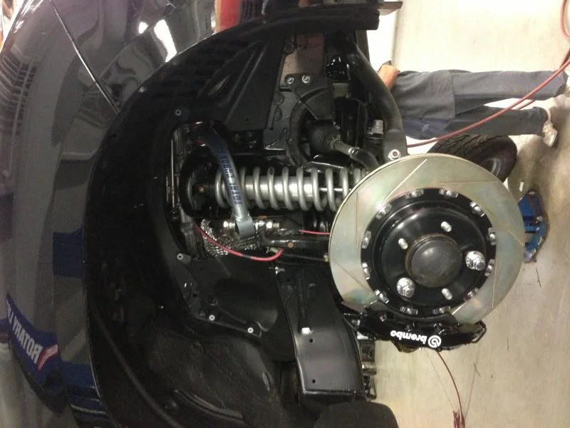

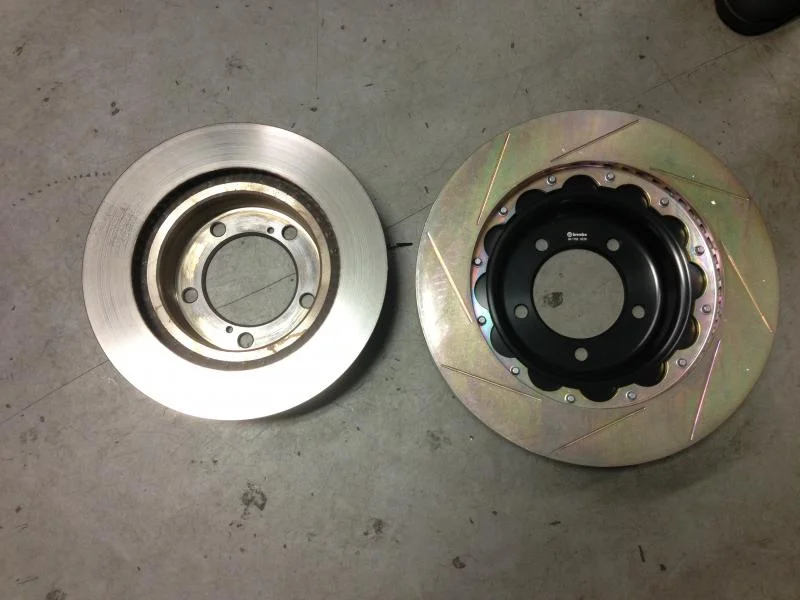

amir904, i have no choice as i am installing Brembo 6-piston caliper front brakes which are very big and require the larger rim size. any suggestions i would appreciate.
i just hope that the 305's don't rub

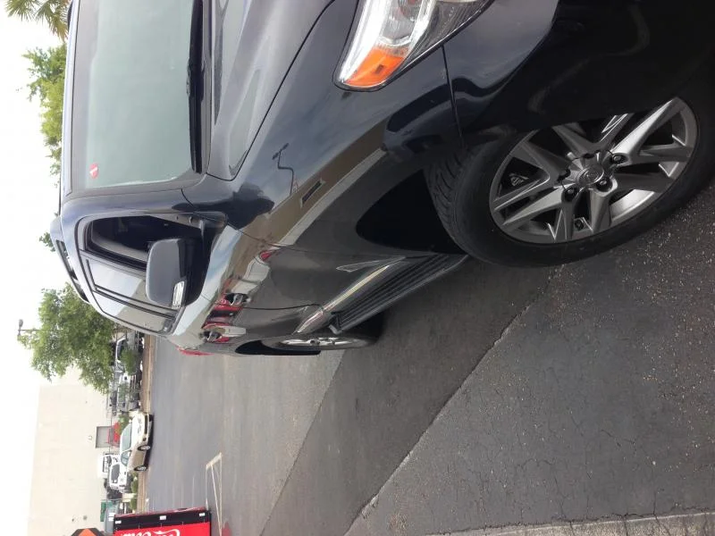

Can you take a closer pic on side view i wanna see the wheel gap and height. What spring did you use for the rear?
How big is the difference from stock tires with the new one? Looks like stock

I think unless you get aftermarket wheels with different offset you will have rubbing issues on the upper A-arm with that wide of a tire, unless you swap those out too, the 285's leave very little room, you would be increasing your width almost a half inch in each direction and when the tires are turned the gap becomes even smaller, just my 2 cents...
I just read the post above, I guess I was wrong, looks like they fit? I would also think what tire brand you go with will affect it too, I have the Goodyear Duratrac 275's and it's tight, I'm guessing a 305 tire with side tread would be super tight, just my guess...
Take a close look at the pics he posted ... You can see the Total Chaos UCAs behind the front tires.

how much additional clearance to the Total Chaos UCA's give you?
I looked into this option as well and I think you can get away with a 19 inch wheel, however we start to split hairs between the two sizes.
If you do this, take lots of pictures and show clearences around the wheels. Give us a good feel for how things changed...before and after.
That kit solves the problem of the lack luster breaks...but there is a cost and that is a larger wheel. I don't know if I want to jump up in tire size just for better brakes just yet.
