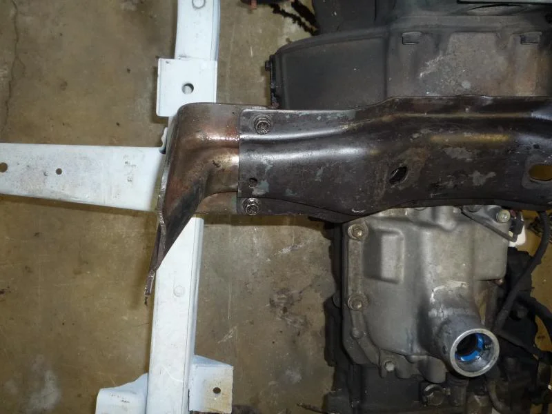

Was able to get out and clean off the FJ60 Tranny support. This succer won't fit as expected. I'm thinking about keeping it and cutting the outer supports and welding them back so they fit within the frame rails. Or finding a 1985+ tranny mount (doh just sold one) and custom fitting that. That would probably be easier. Now I'm forced to look through all 1500 pictures I have to figure that out.

You can see I lowered the engine to show how much wider it is within the frame rails.
Hey Mike, when I did that swap on one of my other 55's I just cut the end of the ears off and redrilled holes, I think I had to notch the crossmember a little but it turned out really well. I just welded the mount ears(?) to the frame. No pictures cause this was waaaay back before digital cameras ;)
