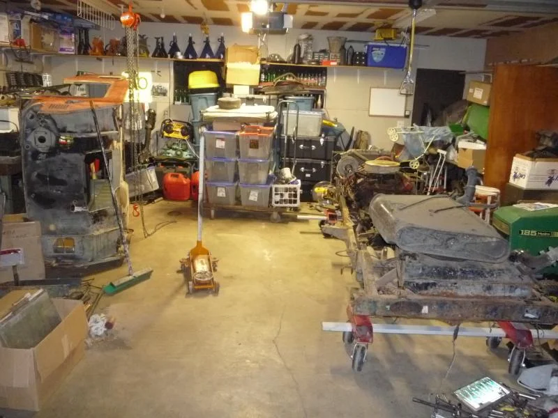

Got in last night late and got my cruiser fix by cleaning out the garage and pulling "rerun's" body off. Pushed the rolling chassis to the back yard and will be selling it soon with chia's tub and junk.
I was glad to see that the new 4 link control arms were here when I got back... that and the FJ60 Truss for the 60 axles. Tucked them all away for a rainy day. A friend Aaron is going to swing up with his welder and we will go to town on the spring over and rear 4 link in a few weeks / Month as soon as I get all the body junk sorted out (figure out what I really want to do).

I needed more room so I move about 30 crates to the barn. That thing is chock full o cruiser.
Pulled the engine and started cleaning up the frame. The tranny/transfercase support had 1 bolt in in... no nut... just gravity holding it there.
I shake my head at the PO.
Now I'll have to take the front and rear frame bumper supports out... they are both trash. Also think the PS is a Scout box bummer there. I need to think of what to do for PS now. Use the existing (re-weld) or go a different route. check out the welds the PO popped in...:eek::eek::eek::doh: It all needs to be ground out.
I'm almost in new territory... putting something together. After I get the front end unbolted and the bumper supports pulled I'll grind all the hack welds down and send the frame to the sandblaster so I have something clean to work with.
