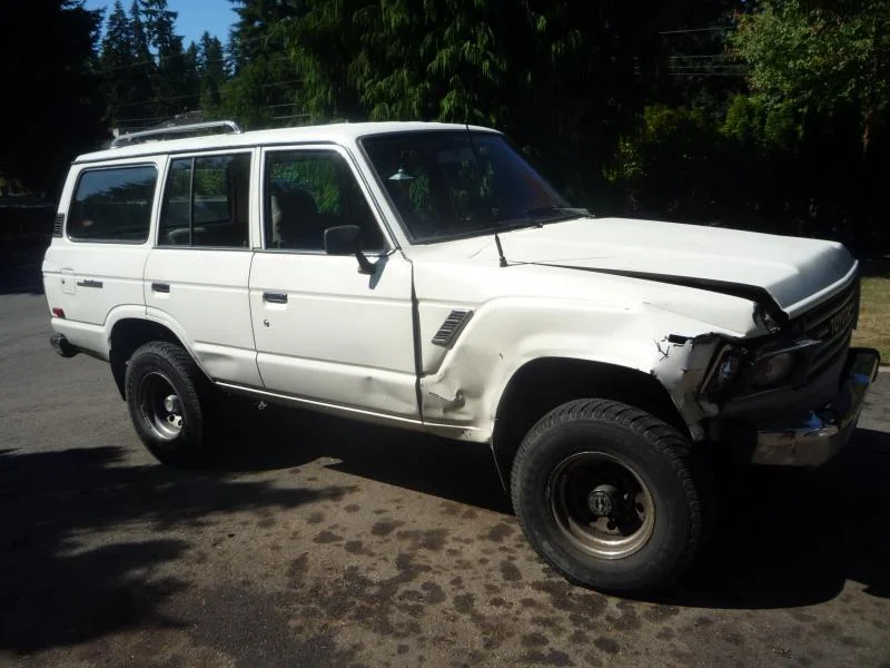

Got some done today. Picked up another 60 which took 5 hours so had a start time of 1pm. Was still able to get 7 hours of work out of my fat self.
Pulled the front clip off the 60 and pulled out the interior. The Axles are going to "Marks Toy", the Body is going to Canada. The drivers door to Mass and the dash to Michigan. The frame will go to the back yard with the 4 other FJ60/62 frames. The rest will get catologued and put in bins.
Before I disconnected anything I warmed the engine up, Opened the choke up fully on the webber carb, pulled the plugs and took some compression readings.
It was about 15 off at most. Seems like a good engine. The top end was worked on recently. It drove very strong and shifted nice. I think It needs a new rear main seal though. The tranny 5 spd tranny has 6k on it. The transfer was rebuilt as well and installed when the 5spd was. The guy I got it from was a great guy. His daughter snuck out and wrecked the truck. Doh!

Here are some pictures of today's events.
Brute strength. For a minute I though I was pulling a horse instead of it pulling me.
main.php
What I started with today.
