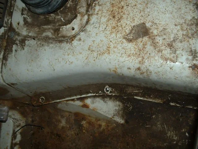

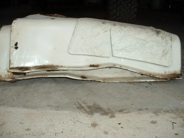

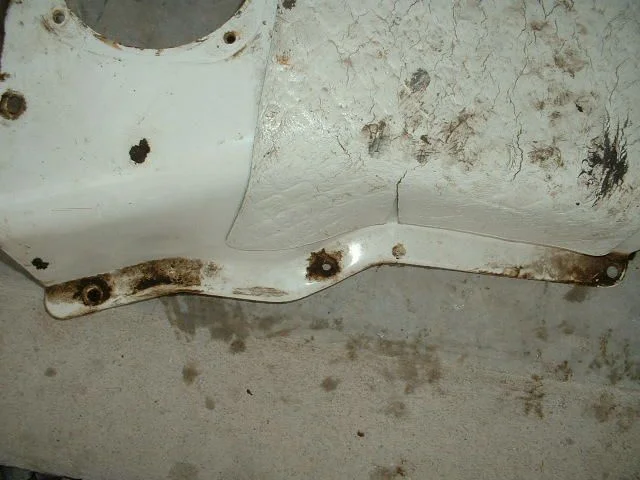

there are 3 diffenert styles of hump, the tops are the same shape, it's where they meet the floor panel. so using a 4 speed hump in a 69 won't seal very well as it does not sit flat on the floor.
I'll see if I can dig up those pics.
1st is a 1970
2nd is a 76?
3rd is 76 ontop of the 70
Gotcha. Yeah, I need a 1970 one then. With a little fab work the 4 speed can be sealed up though. In case anybody is interested. Thanks for the info, those pics are very beneficial.

can't find the pics with all 3. I think the splits were, early-column shift, early 70's 3 speed floor shift, late 4 speed
I think I sold my 3 speed floor shift one, I've got a 3 speed column shift one.
IMO better to go with the column shift tranny hump if one is a available........I have had them both side by side and there is a lot of differences in the curving......as you can see in the pix one will not fit over the other very well and it is not only a matter of the openings for the shifter but a contour problem as I remember................when I was in Central America and these pigs were workhorses the column shift was very desirable as they could seat 3 adults on the front bench; check with3_puppies, he is a lot closer to you and might be willing to let the tranny hump go:D
