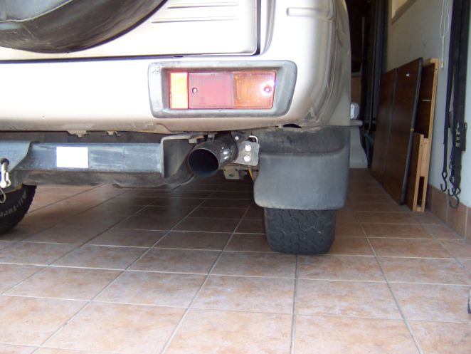

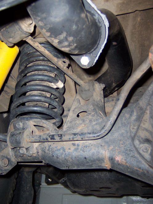

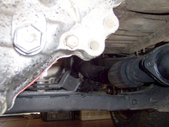

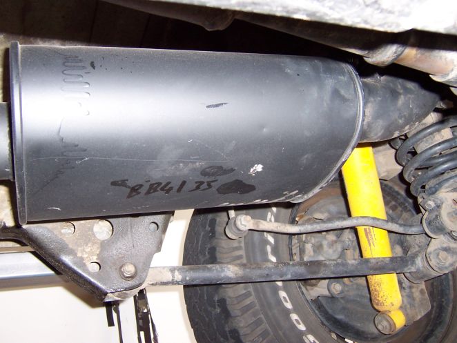

Finally got some pics of the 3"
Here ya go guys and gals.

Down under the body.
Through the little muffler, straight through not baffled.
Up over the rear axle. A bit twisty here but all good and clear of the axle housing under full flex.
And the black stuff comes out here.
