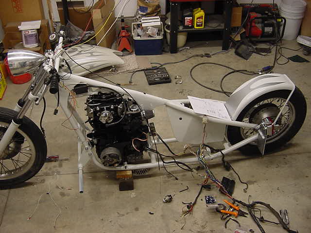

About 3 hours on the bike tonight.

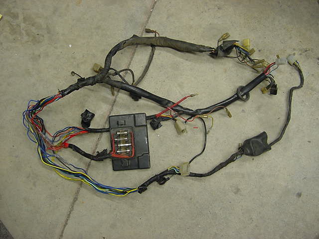

First half hour was spent re-building the carbs. New gaskets, needles and seats, pilots and main jets etc..... The next 2.5 hours was spent wiring. I had a friend of mine at Polaris Industries a few weeks ago go through the factory wiring schematic and eliminate every relay and safety device. Took a while, but un-wrapped and cut everything up...re-wired. Hooked up some fuel....I have never heard this thing run before, until tonight.....and it had been 8 years since the previous owner had started it. Actually sounds pretty bad ass with the straight pipes ;p Thing ran and idled perfect, very happy.
Hoping to clean up the wiring tomorrow, make that look all pretty and get that tucked away. Start hooking up all the misc. small stuff, but still hoping to wrap up the bike project this weekend.......then back to the 45. The last pic is just some of the wiring that was eliminated.....it does not include the pile of relays and other little boxes laying in the corner.

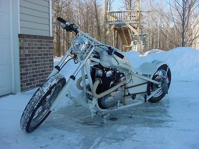

Nothing against Yamaha but if you tricked out the motor sidecover/logo and covered up the logo, you would really throw off any gawkers and leave them guessing. Nice work, you definite make productive use of your time.
I agree with the Yamaha thing.....I have nothing against them either, but if I show up to some biker event with Yamaha still embossed on the side....the thing is probably going to end up in the campfire :o
I do have plans to get rid of that, probably going to pull both side covers and mill the yamaha out. Either nothing on the side or might mill up another aluminum plate and press it in.
Thanks, Matt
Kinda looks like a old 650 triumph hardtail,neat paint job Matt.
I really like the look of the motor also. I believe when Yamaha designed this motor they used a Triumph motor as there template. It's just different, not the typical V-twin you see in everything now days...I guess that's what makes it cool. Different....kinda like a landcruiser ;)
Thanks, Matt

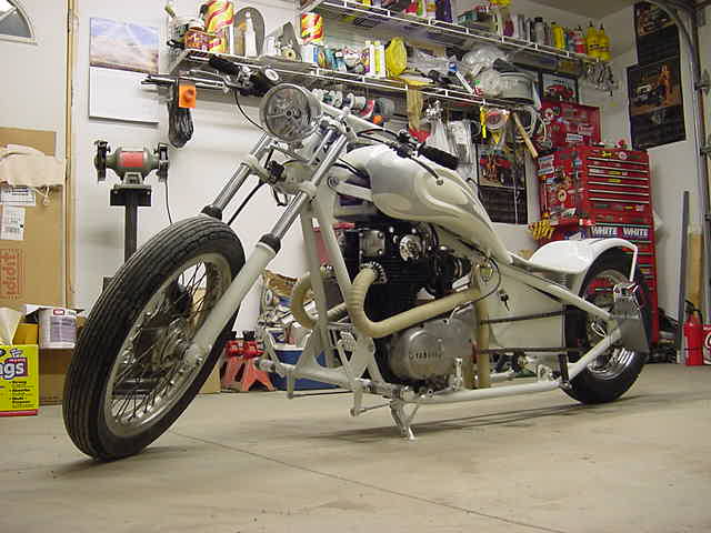

About 3.5 hours yesterday on the bike and about 3 hours tonight.
Yesterday was spent cleaning up the wiring and making that look all pretty. Didn't take any pics because nothing special about it, just cut, solder and shrink wrap.
Tonight was spent doing a lot of misc. stuff. Installed the idler sprocket assembly, clutch cable, sediment bolt installed, fuel line, hooked up shifter linkage, adjusted chain tension, kick stand, and all sorts of little crap I can't remember....
I still have to cover the seat, the piece of leather I got from the local saddle shop is to small so I am going to have to round up another piece. The piece I got was brown, but thinking I want the seat black so that's ok..get what I want now.
Few little things to do tomorrow I think, light bulb hook up, tail light hook up after I get a couple connectors at work, but I don't think it will be a full day on the bike. She starts and runs like a top, had her up on blocks tonight and I was shifting through the gears....everything seemed to work ok. Of course will know more this spring when I'm going down the highway and stuff starts to fall apart.

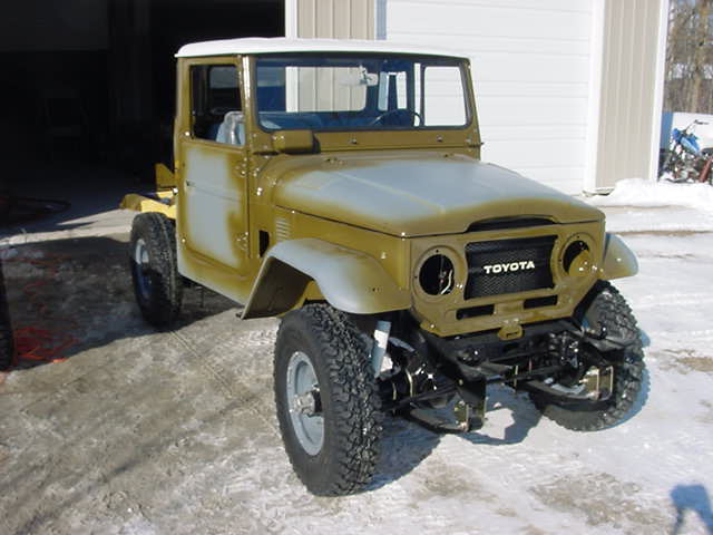

Dug the box out and went to work on that. The front panel was bent forward very bad. There was no way I was going to be able to pound it straight while it was on the box. So, I drilled out all the spot welds and pulled it out. I was then able to put it on the floor and pound it straight. I actually had to use some blocks of wood and step on it to bow it back. Actually got it pretty decent. Inside of the box is going to be Sem'd so any little imperfections will be covered up. The other side faces the cab, so you don't see much of that anyway. I'm sure I will still block it out many times since I am anal retentive.
Pounded on the sides of the box for over an hour, just using the hammer and dolly to take out any little dents here an there. Tomorrow I'm sure there will be more of that, probably try to get the front panel blasted where I pulled it out and primed and welded back in. Starting welding up cracks in the bed.
Took a few glamour shots of bike and a drove the lpb out and took a few shots......to get us back in the mood ;)
Matt
