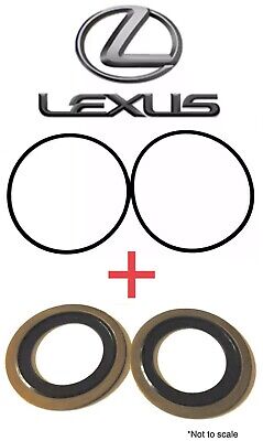

So if anyone comes across this issue, I ended up just ordering new cam timing tubes for my LX470. However for my 2005 Lexus LS430 with 250k miles, I ended up changing the oring inside it and so far no leaks. It was a very straight forward and easy procedure. One of the tubes was slightly weeping either from cam seals or the oring but the oring was extremely brittle on both sides for reference. I think I used the oring from this guy. No affliation with the link.
