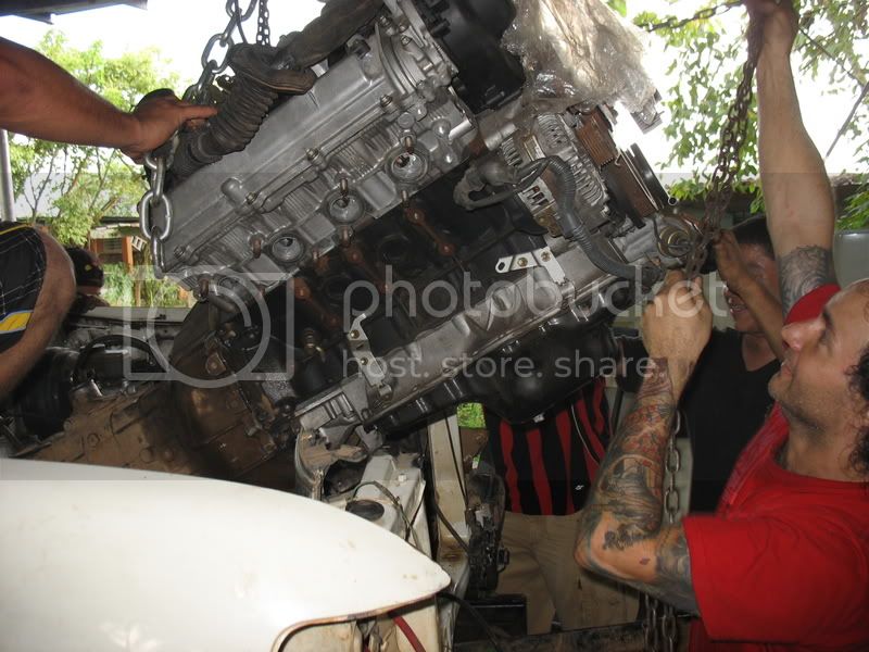

Little update for this thread .. I already buy the engine, from a 2003 Toyota Tundra and go with cams, heads, rods and few more thing to get it up to 250 rwhp . !
It will take time to be done .. I hope some pics of the engine and the upgrade process

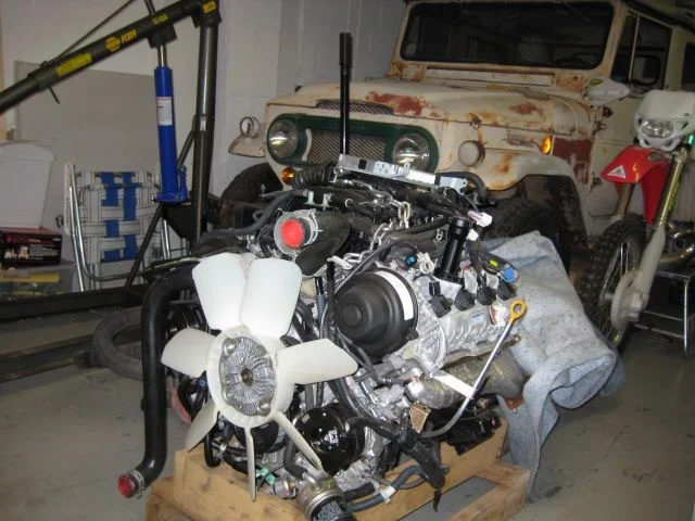

Little update ..
Get the engine .. :D
from a tundra with 50k miles ..
Complete with MAF ( not showed in the pic ) alternator, AC compresor and harness .. :grinpimp:
Now go to the new heads valvles and other stuff process ..

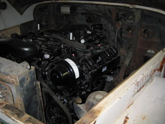

I have been "Slowly" working on my 1962 FJ40 engine swap using a
1UZ or 2UZ....presently I have a 1UZ Toyota marine engine just setting in it doing measurements and was going to use a manual belhousing to use a Toyota manual trans but I have changed my mind...
I picked up a complete 4.7 drivetrain with harness and ECM that I'm
going to use instead.. There are a couple of places that make manual belhousings for the Toyota V8's..

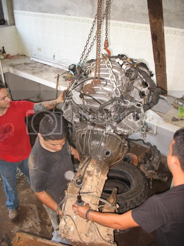

Today I got the gas pedal, with the under dash harness, starter cilinder and key, along with the ECU meanwhile here is some new stuff .. 2UZ mathed to H150 tranny .. HF1A t-case ..
almost in ..
