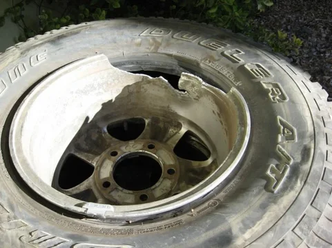

I was out Wheeling with Spressomon and Locrwln1 in the eastern Sierra and then headed back solo to Hwy 395. Dirt road, 35MPH, S-turn, eyes on iPod, up right embankment, on two left wheels, corrected, over left embankment and found boulders. (which kept me from rolling over)
Aluminum rims absorb energy very well.

I didn't feel anything for a day, then the clavicles started that dull ache from the seat belt. My pride was the worst injury. It was a ride to remember though...

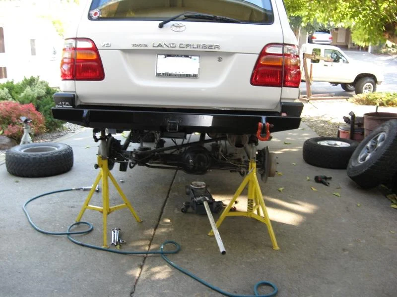

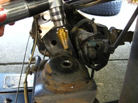

The Air Lift Bags that I have have been working out great on the 98, and now the 99. They simply go inside the rear coils and you have to drill out the hole on the axle spring mount bracket. The first trick is to get the rear end high enough to then drop the axle enough to get the springs out. I have some overkill jack stands so it worked out good.
Then you have to drill out the hole for the air lines to go through.
Then slide the bags into the coil, and attach the hoses. Feed the hose through the hole and fit the spring up into place. The kit comes with enough hose and a tee to place the fitting just about anywhere in the back. I'm going to move mine up into a corner of the Slee bumper for easy access. And no, they haven't made ANY differerence on or off road.
NOTE: When ever you are working around the axle, just get the spare out of the way. And watch the tension on all the ABS wires, and brake hoses when you start dropping the axle. You will need to disconnect the sway bar to get the axel to drop enough.

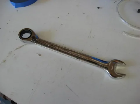

One thing that helped SSSOOOOO much much having the ratchet wrenches in the right size for the top shock mounts. I installed the Bilteins on the rear while I was at it, and you'll need a 7/8 wrench for this. $30 for the one wrench was well worth it to me. It cut the job in half from last time with a box wrench.

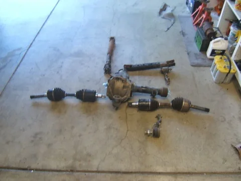

I decided the salvage yard will get a 99 front diff. Some time in the driveway and the donor now sits with about a 6 inch lift in the front. It's amazing what all that stuff weighs.

Now on to swapping it into the 99.... the diff, not the shocks.
