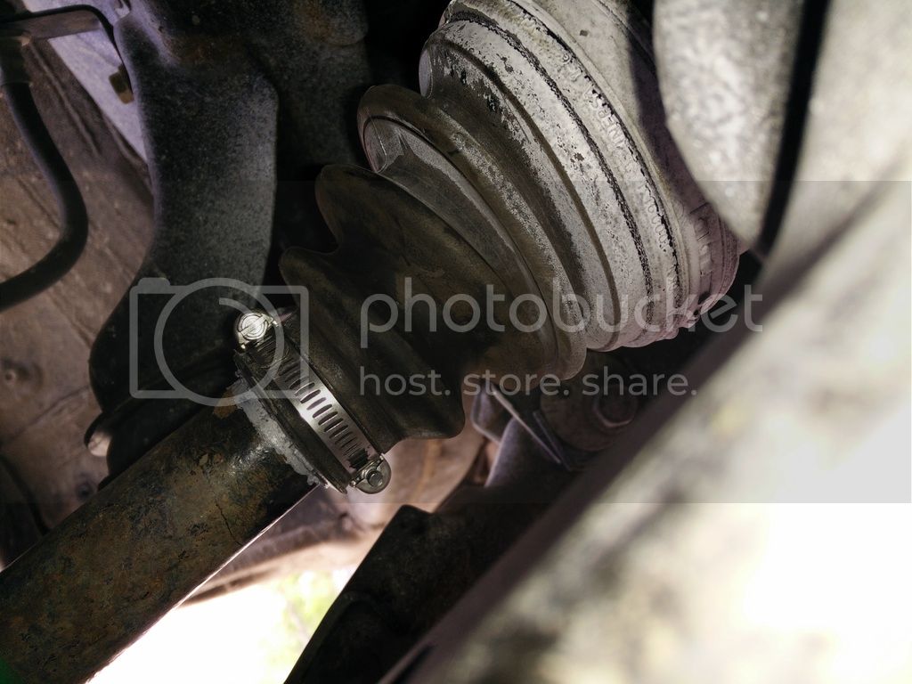

Looks like I have too much angle for the inner CV boots now. Did you guys encounter this issue and if so, how did you solve it? I think I'm going to stretch it and re-clamp.
That sucks bud sorry to hear it, so far I don't have any issues and Spencer never mentioned any either. I wanted to stay away from the diff drop spacers but I know several kits go that direction. I did do the the carrier bearing spacers though. I have one of those toyota clamping tools for their cv boot clamps I found they held up much better than the aftermarket ones i tried in the past. Whats your measurements after the lift?
Most of the guys I've seen talk about stretching the boot have trouble getting it to stay unless they do the "Boot Slide" mod. The guys with 1st Gens do it all the time. I would think it would work for a 2nd Gen, I could be wrong...
I had a hard time finding a good explanation on Mud so here is a link to TW: Boot Slide mod. No more blowing cv boots.
That's what I'm looking into John.

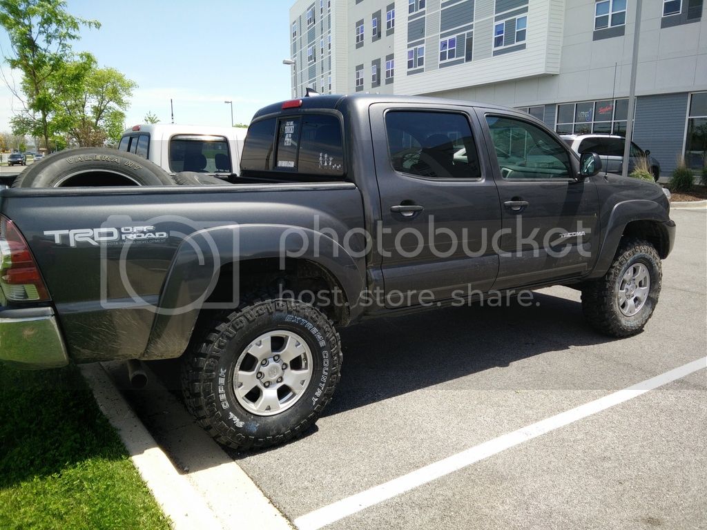

I'm at 23" hub to fender Larry. 2 fins are touching on the passenger side, but I can see daylight between them on the driver's side.
For now, I coated them with dry Teflon and will apply some type of fix this weekend.

I have 22inches on DS, and 23inches on the PS. Was waiting to get my sliders on before I added the spacer on the DS to even it out to balance the DS with the gas tank.

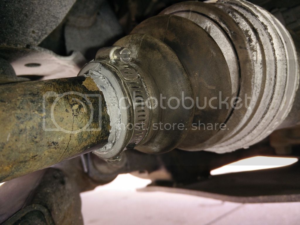

My outers are good. Inners, not so much...
I cleaned up the shafts, wire brushed them, and coated them with some firm hardening-oil resistant RTV. I let that set up for over an out to get it really good and tacky because the boot wanted to slide back if it wasn't. I used two #6 clamps, tightened evenly, once stretched over the silicone. I took it for a couple of trips to town and it hasn't moved yet. I'm going to keep my eye on them over the next week and if they move, I have other ideas.
