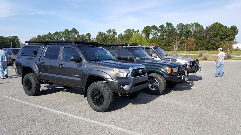

Very nice that looks great. Did he go with the 285's? Very happy with the way it turned out I just finished it Saturday and took it for the alignment. After driving it a good bit Saturday evening and Sunday I'll need to swap the coils to correct the drivers lean and will likely drop it down half an inch in the front. I went the max height at 2.5 on the 5100 with Spencer's 2015 factory coils and its a bit too much tension on those coils. I get vibration through the rack and pinion and the new coil springs seats are tearing so hopefully that will remedy the issues. I ditched the front sway bar. The tires are not overly loud on the road you can have a conversation with no issues and have a good aggressive feel to them. Spencer just got back from Colorado and said they did great in the snow and terrain he encountered. Here's a pic waiting on the alignment Saturday.
