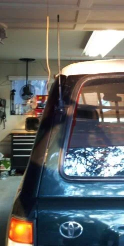

Here is a pic down the profile of the rig to show protection. That is the sbb1 in the pic.
