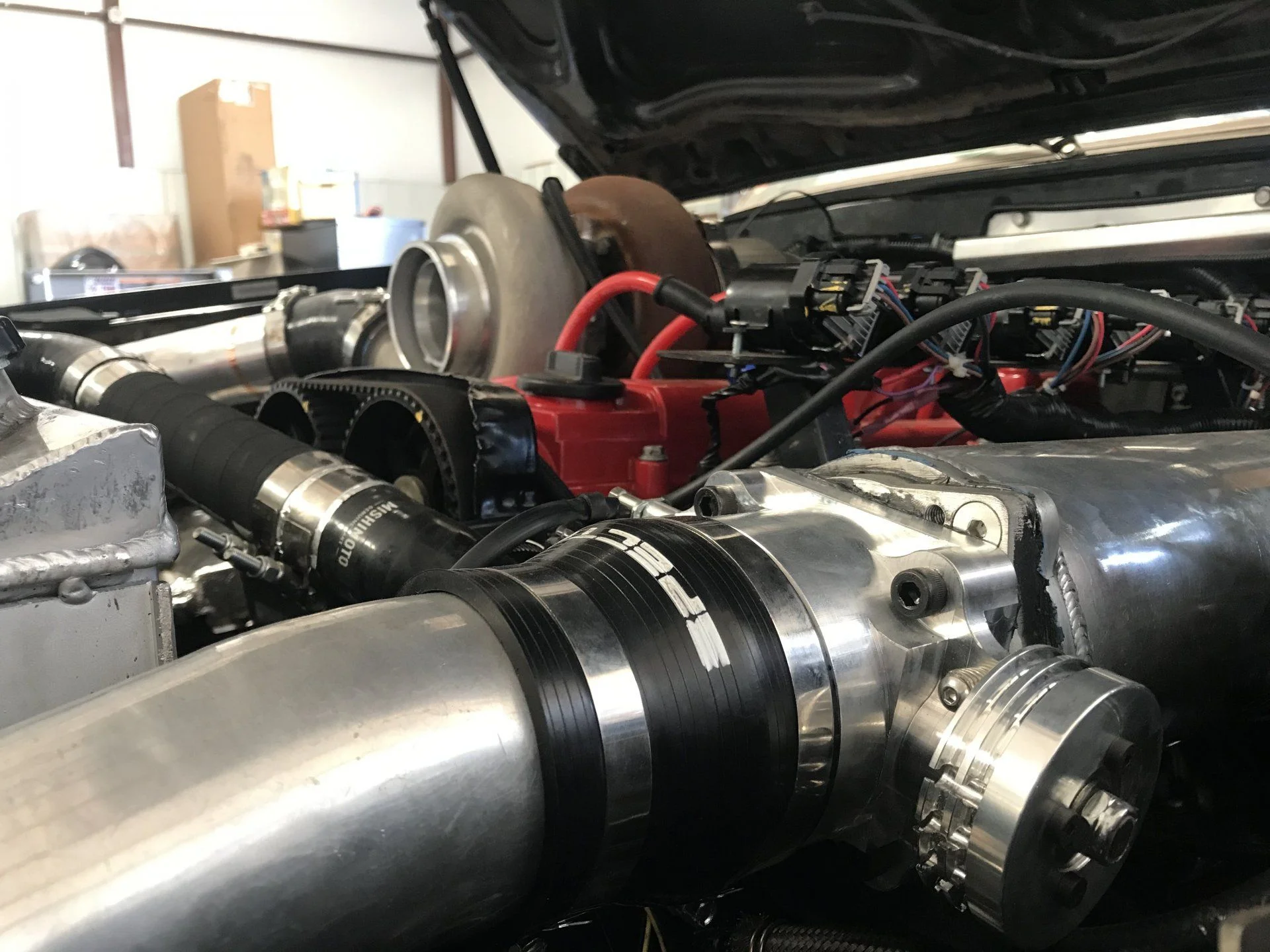

I mentioned you but i didn't know who you were, just that i saw your build. nice project, it has an R series swap too correct? how does it drive? I know how boosted JZ's operate but like i was saying i figured the the high revving aspect isn't best suited to the LC speed/engine operating range, don't get me wrong i love what JZ's can do but i figure why not just keep the added displacement +boost??? got any vids of your rig in action? :beer:
On the highway on stock gears and 37s it’s fine if you’re cool with burning gas
Have dual cases so off road is easy
Yes have an r series bout to rebuild it
When I got my truck it was just a roller and had a 2j in storage so figured why not.
I will say with the 2j or a 1uz lots of options and lighter than the stock driveline not to mention cheaper abs easier to find.
And yeah check out videos on my insta 1348_racing
