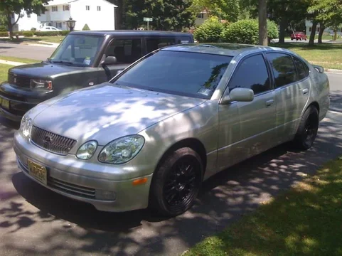

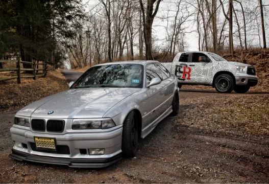

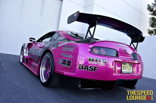

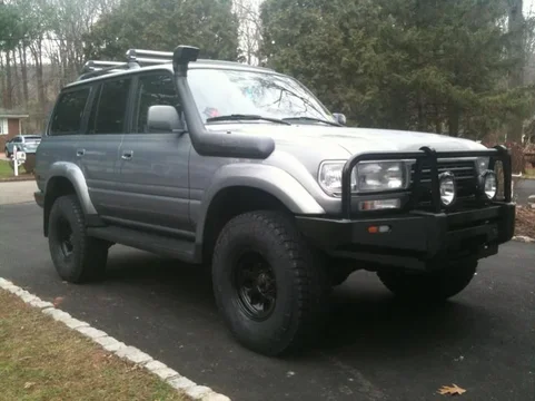

Pics of the GS and Supra? Sounds like you got a straight six fetish:grinpimp:

My poopra
My 80
GS before drop
Another straight 6
For the supras that run 11, I did that with stock twins.. 4whp
