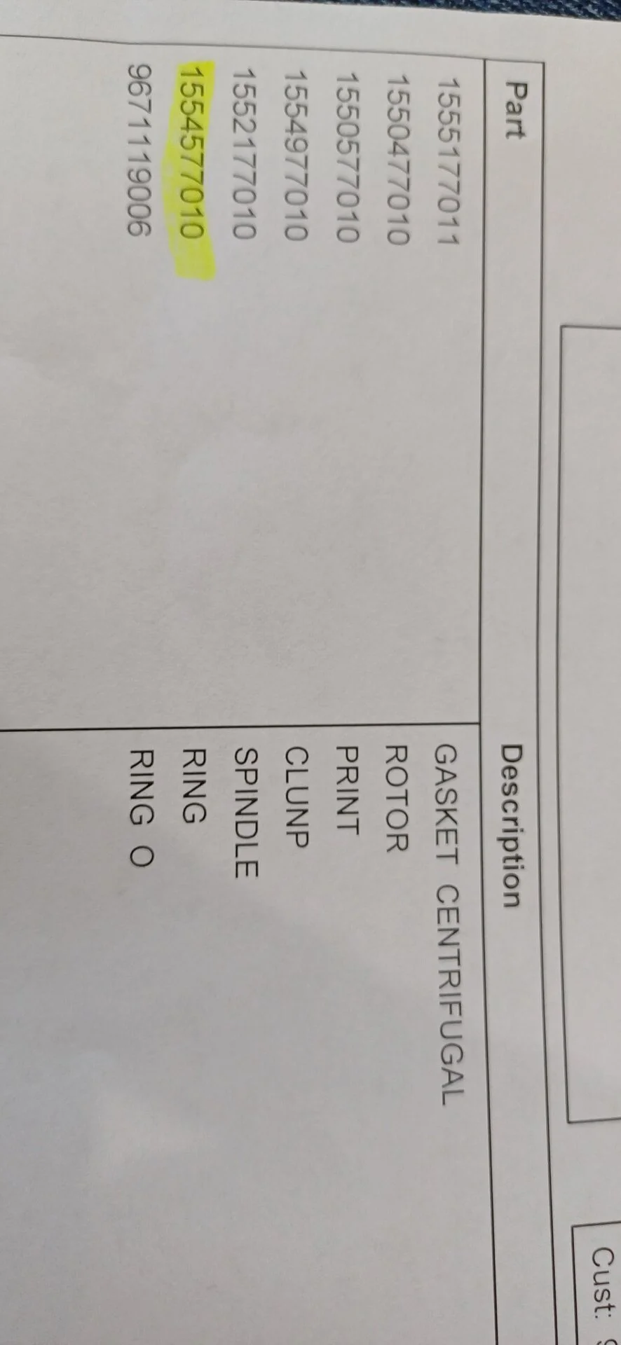

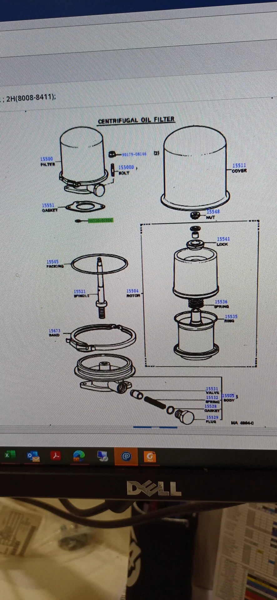

This is the only corner of the internet I can find info on these. Any idea what year they stopped doing them or where I can find the filter assembly? I bought a 2h to do an engine swap on a 1988 hj75 and the engine must be a later model like you said. The engine I bought is missing the spinner cover.
I went to toyota a and found some part numbers if that helps anyone. They could only supply one o ring (highlighted)
You can change back to a standard oil filter housing from an early engine that doesnt have the centrifuge.
