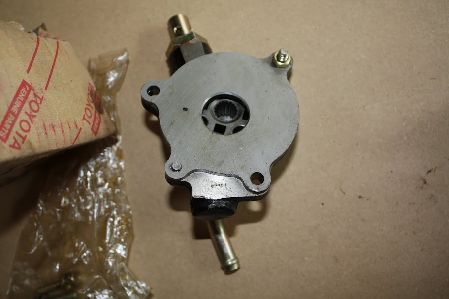

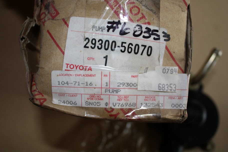

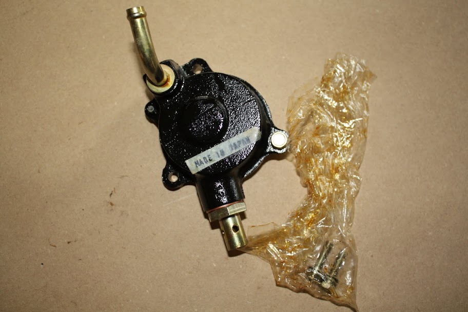

The ones I have are PN
29300-56070 which ToyoDIY says fits...
('8411-'8808)13BT,3B ; ('8808-   )13BT
I don't know why that PN isn't the same for 2Hs but the outlets may face the wrong way or something.

Dunno if all dealers have access to 2H parts but I would suppose they do as 2H equipped trucks were sold across the country.
I simply called my local dealer (pretty average size dealership) and supplied them with past numbers and the parts came in the next day. I understand Toyotas main wharehouse for parts is in Toronto, Ontario.
You need to give them exact part number though, if you want to facilitate the procedure quite a bit.
My be worth giving a try before ordering from Europe or something...

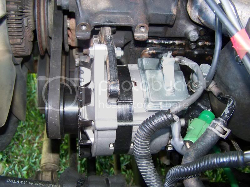

Cheers, It is not necessary to take the compressor off. Remove battery cable. The adjustment bolt is straight under the air con compressor and the bracket bolt is easily accessible and the nut on the end just needs a ring spanner on it to stop it turning while using a socket on the bolt.
Disconnect the wire when the adjustment bolt is out and you swing the alternator down. Then remove bracket bolt and nut. cheers
