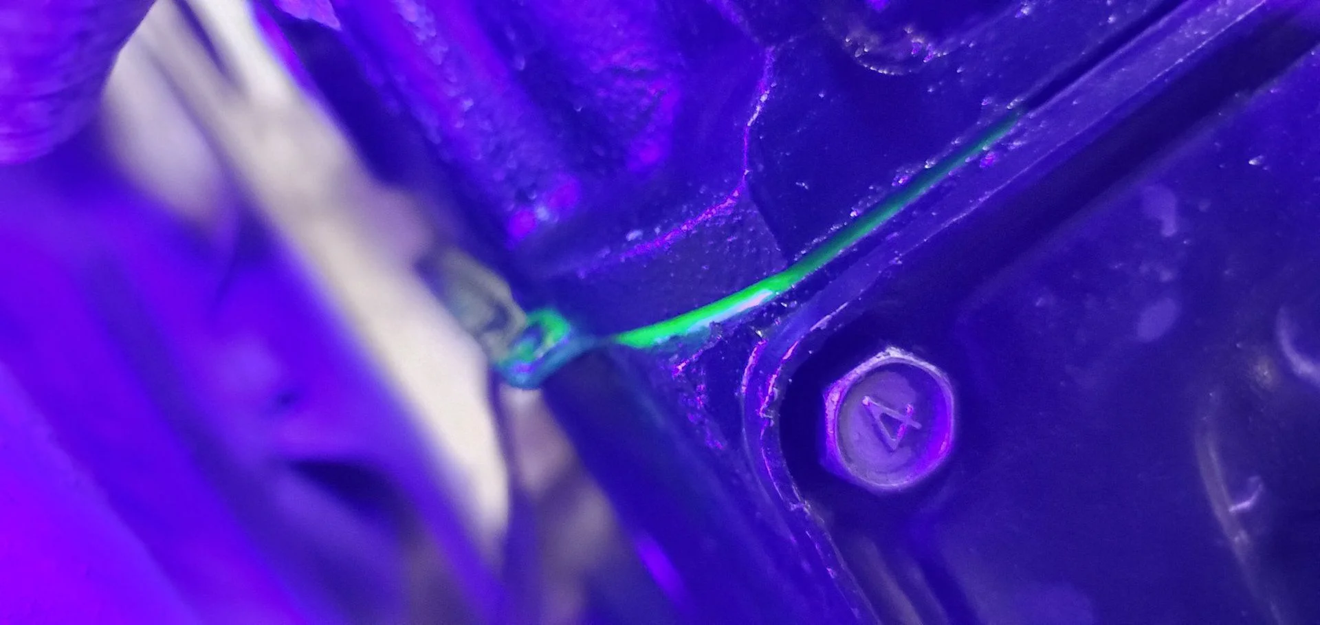

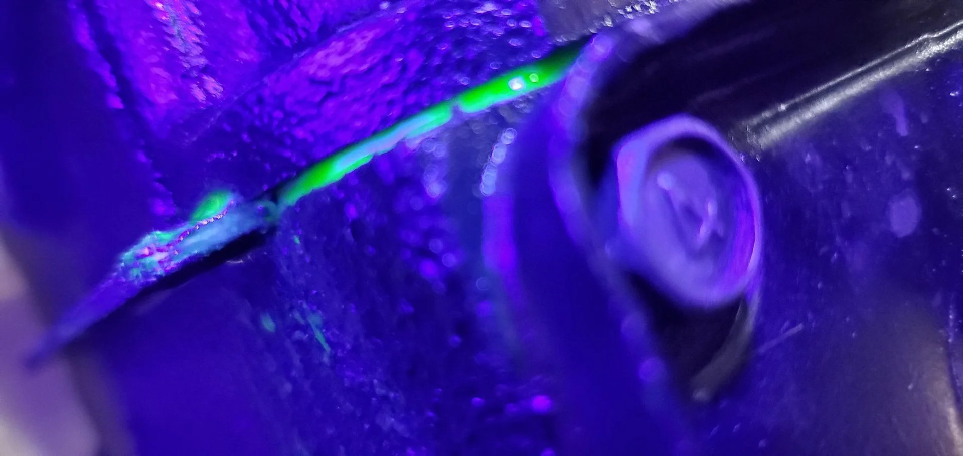

I just rebuilt this engine myself and had it machined at a machine shop, Less than 15k miles on it. Ive been chasing coolant leaks because I decided to reuse old cooling hoses. All the hoses are fixed now but i still had drips under my car when i park, so i put some UV dye in the coolant to see where this fresh coolant was coming from. It first appeard to be coming from the back of the head gasket but with further investigation i can see it with a blacklight, the coolant is leaking from the bottom of the rear freeze plug and flowing around the HG.
The machine shop replaced all the freezeplugs for me. And there is no UV dye coming from the top or sides of the freeze plug, just the bottom. My next course of action is to pull the head and pray that its not cracked... any imput on to what else i should look at would be fantastic...

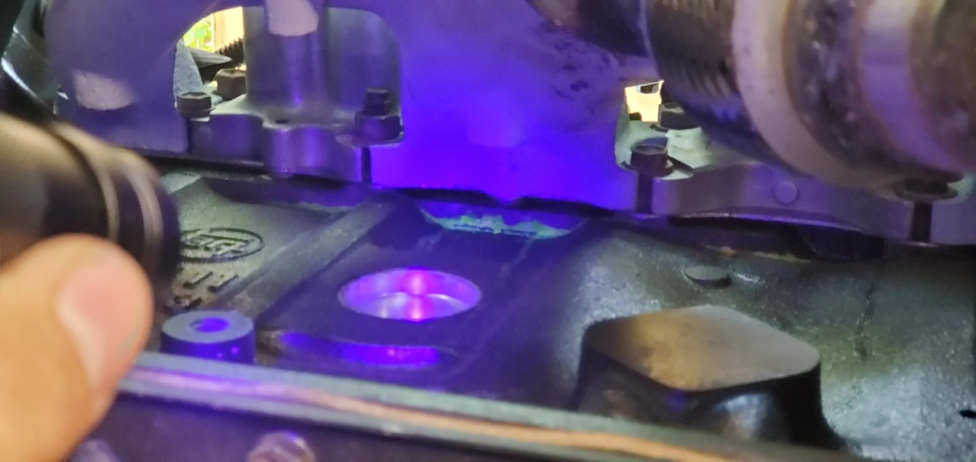

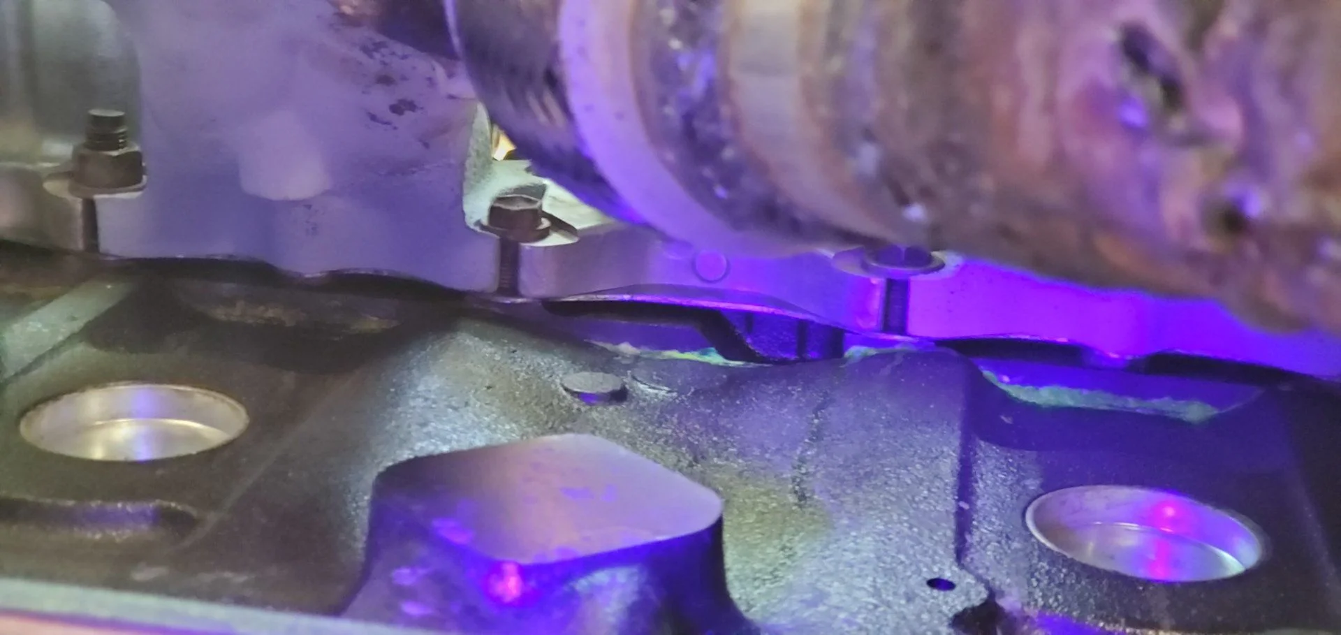

Best pictures i have, couldn't get my phone camera to see the freeze plug leak/potential crack.
Head gasket... the the light green is coolant. The importance of torque sequencing cannot be played down.... new leak is coming from the other side of the block. Im going to go ahead and just fix it
