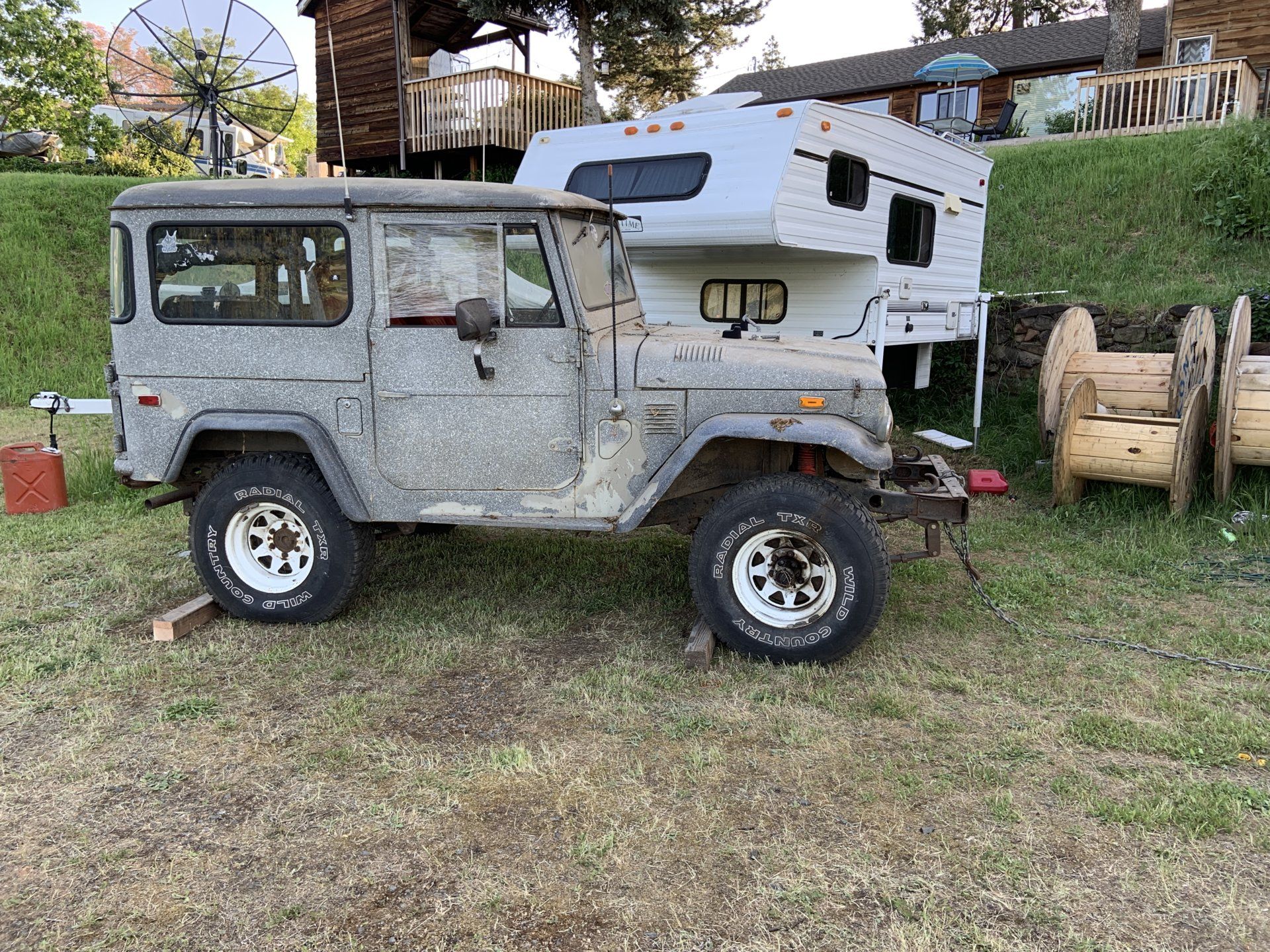

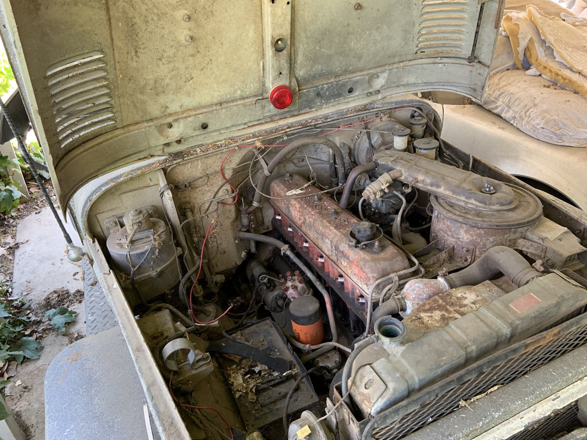

Hey there all I joined the fj40 club with the purchase of a 1974 and can't be more happy. It has been parked or over 12 years and is a pretty straight project but isnt running. The guy who sold it to me said his brother had messed with the distributor and that somehow he didnt have it in right and it blew the motor up. This is totally going off what he said and it might not even be true, might even run ? My question is what do you think I should do before putting power to it and seeing is she starts ? anything is helpful thanks a ton !!

Also, some pics of your new rig would be nice when ya get the time. Engine too!
Ah, ya beet me too it. I believe you have the transition F and not the 2F. Often called the F.5. Same bore and stroke as the F but with the 2F type oil system.

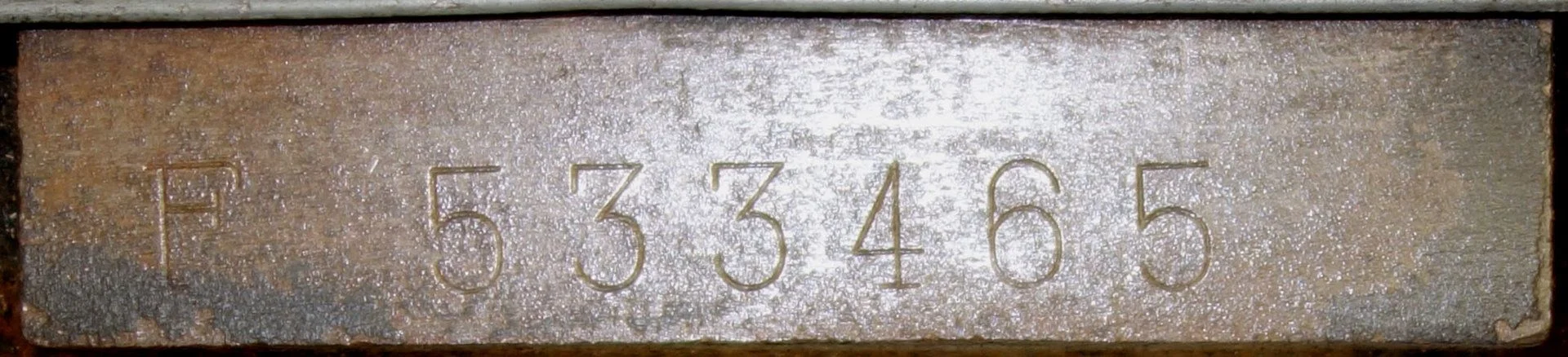

74 was a transition year. They went from 3 speed to 4 speed. And from F to F.5. Where your oil filter is shows it's not an F. And the 2Fs had aluminum valve covers. You can ID the engine by a stamp on flat spot on the block behind the dip stick and just below the side cover.
Yikes! Just noticed you're missing the side cover and the push rods are exposed. Not good.

Here's what my May, 1974 F.5 engine stamp/serial # looks like.
