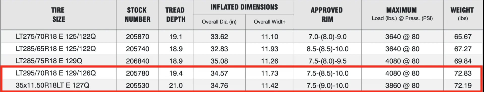

305/65R18 —> wider than 295s by 10mm
295/70R18 —> not as wide than 305 but taller by 5mm on the aspect ratio (more side wall)

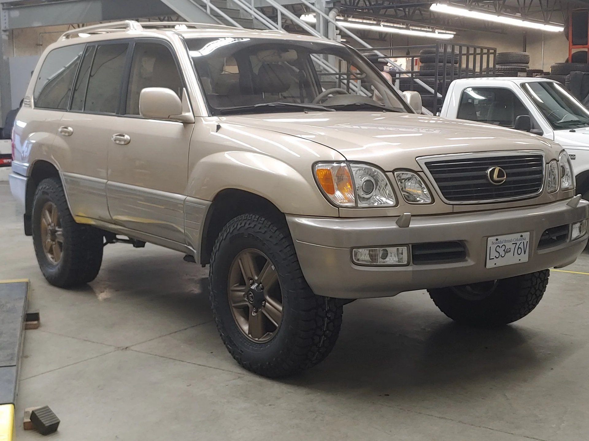

THEY DEFINITELY FIT:
2" Ironman Lift and Ironman TBs, BORA 2" Spacers, Pinch Weld Mod, 295/70r18 Atturo XT:
295/70R18 installed today. Falken AT3W

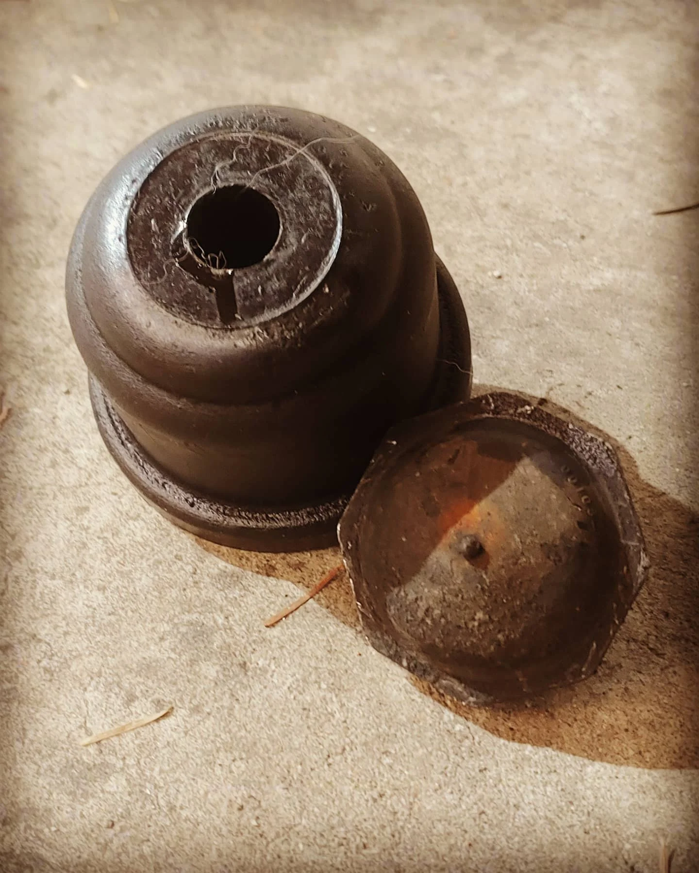

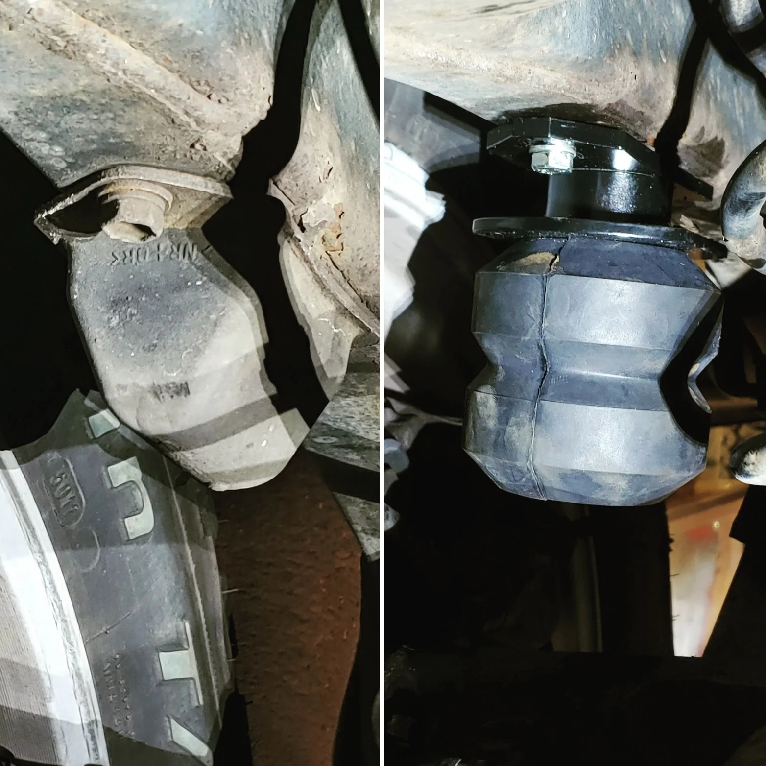

AHC, pinch weld smashed, extended bumpstops
Fits great now!
