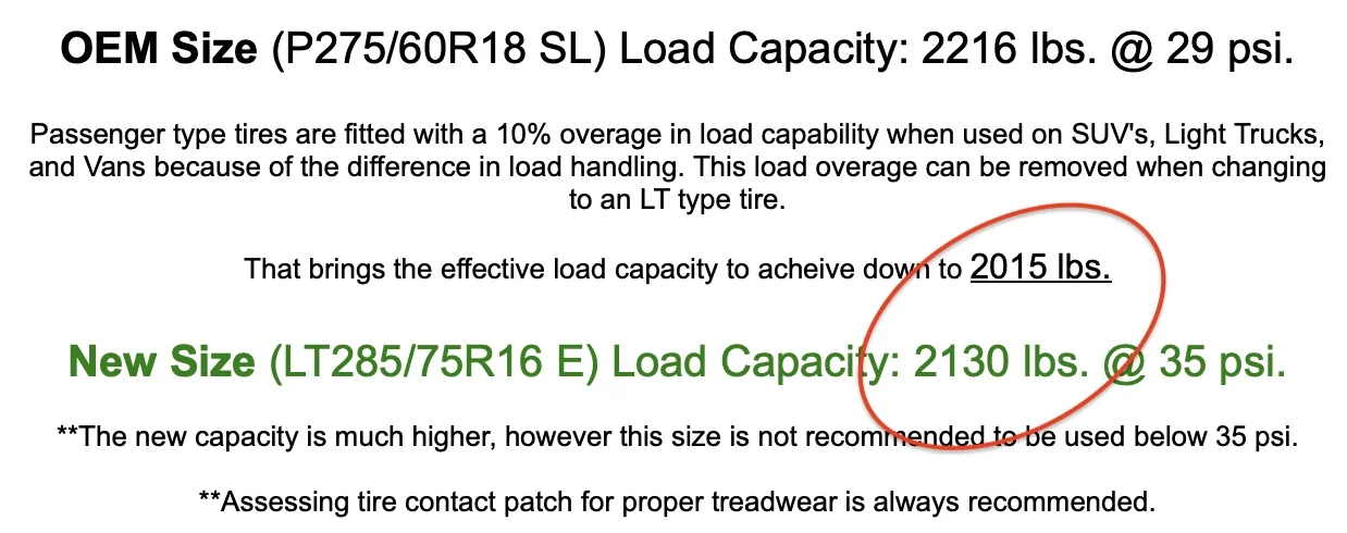

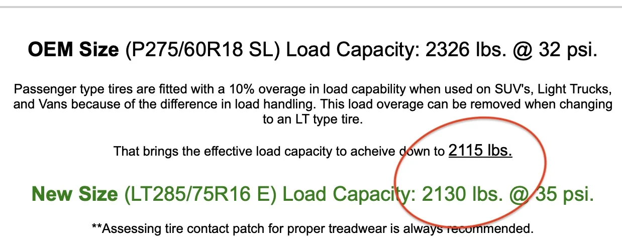

I have a 2003 LX with BFG KO2 LT285/75R16 126/123R load range E tires and I’m trying to make sure I’m using the correct tire pressure. I’ve been reading lots of posts on this subject but still not 100% sure.
I’m coming up 35psi based the Toyo Tires Table I see referenced a lot. This is lowest pressure on the chart and dictates that both the front and rear would be the same pressure. This is making me think I did my math incorrectly or misunderstood a core principle here.
These were the original tires and corresponding tire load limits from the chart.
P275/60R18
29PSI- 2216 lbs.
32PSI- 2326 lbs.
The table says to divide by 1.1 since the manufacturer used P metric tires instead of LT.
These are the adjusted Tire Load Limits for LT tires.
29PSI- 2014 lbs.
32PSI- 2114 lbs.
The LT tire chart lists 35psi for 2130 for LT285/75R16.
There’s also this calculator (I found this after all that math) that gives the same results.
Tire Pressure Calculator - https://tiresize.com/pressure-calculator/

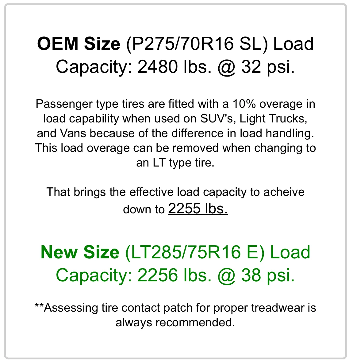

@Grumpy Grumperson You can inflate anywhere in between 35-38psi on your new tires and you'll be fine. The problem with all these calculations is the 100 came in different tires and different tires came with different specs. The GVWR of the 100 is roughly 6860 lbs and the weight distribution is close to 50:50 when unloaded.
The 16" tire/wheel combo had an effective load tire weight capacity of 2255 lbs @32psi but the 18" tire/wheel combo had an effective load capacity of 2130 lbs. So, we are looking at 2,255x4 =9,020 total or 2,130x4=8,520 for the 18" wheel/tires. Obviously, there is a buffer in there and your loaded weight won't be exactly 50:50 ratio. How much buffer do you want?
But going by your 18" wheel placard. OE tire inflated to 32 psi in the rear we get... new rear LT tire should be inflated to 35psi.
For the front, OE tire is asking for 29psi and therefore the load capacity is 2015lbs.
The calculator will only go down to 35psi because the table only goes down to 35 psi. But going by weight capacity, I would be comfortable running 33psi in the front.
My answer is 35psi all around but if you desire a cushier ride, then go 33psi front / 35 psi in the rear.
