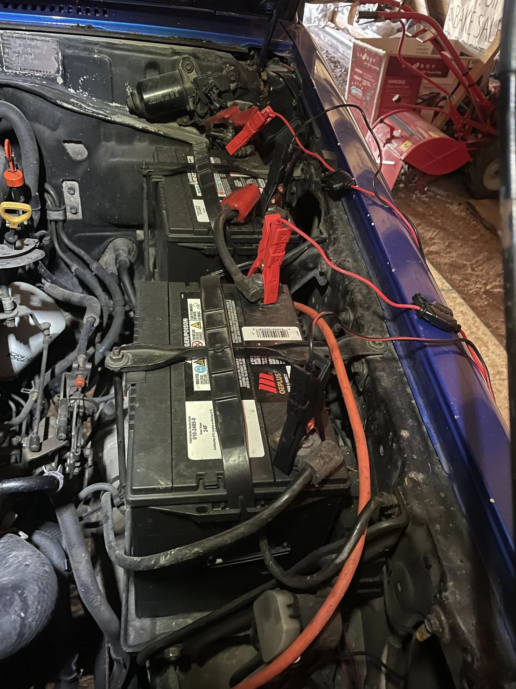

Well - my Noco Genius Gen5x2 just died. Started blowing both fuses on one bank. Did a bunch of testing and it is indeed the charger and not something in the truck. And to boot, I did not realize it so it messed up one of my batteries. I was running Group 25 Duralast Golds and they were fine until this. AutoZone warranteed both as the incident swapped polarity in the battery that the charger died on. AutoZone no longer sells the gold in Group 25 so they gave me two regulars. Not too pleased with that but at least I did not have to drop $400 on two batteries.
I was running the Noco in the engine bay so I just had to plug in the 120v.

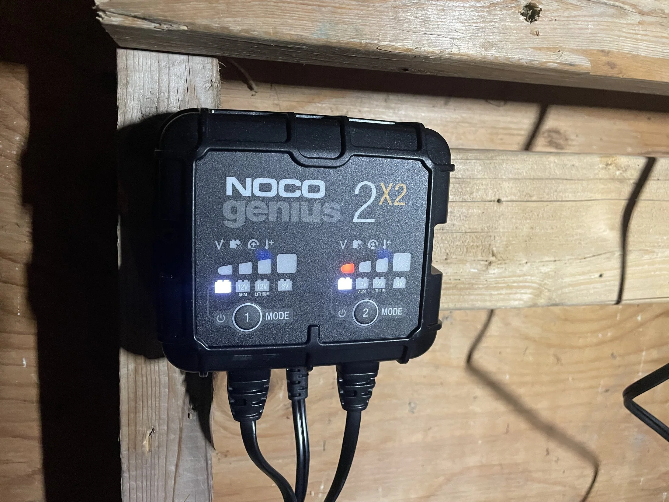

If you're just maintaining your batteries, then the 2x2 (NOCO - 2 Bank 4A Smart Battery Charger - GENIUS2X2 - https://no.co/genius2x2) works well. It's slower charging then the 5x2. I left mine for a day to recharge my two dead batteries, including one that I had to force charge. I have mine in the garage, and hook up to the batteries. As you are running yours in the engine bay, so you will need/should use the waterproof 5x2 (NOCO - 2-Bank 10A On-Board Battery Charger - GEN5X2 - https://no.co/gen5x2).

I do have and have used a two bank Noco as well as single bank NOCO that can be used for 12v and 24v. I think a vehicle mounted two bank is a good way to go, ensuring each battery gets what it needs and any imbalance is minimized. But for my use as a vehicle mounted charger I want the ability to have the fridge on and batteries being charged. I wish the NOCO could that and perhaps at some point they will; Without a cycling load no worries.
