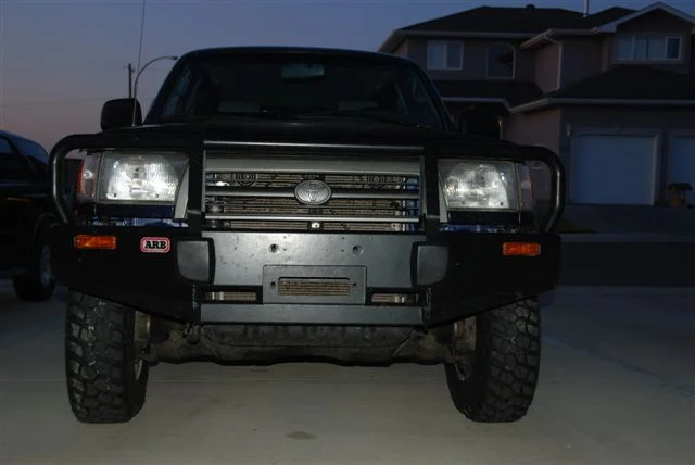

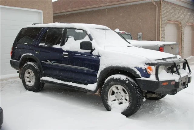

well here you go..my 96 2.7Litre on a set of Michelin LTX M/S 235/85R16's E range 10 ply
Not a big lug tire but I sure liked them for offroading through the firm stuff like rocks and creeks. They worked really well in the snow as well.

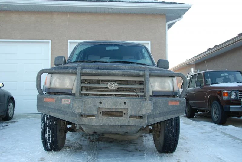

I had included a pic at the bottom..LT245/75R16's KM2's ..i wanted at factory height..about 31 inch and not as wide as a factory 265/70R16
I live 3 hours highway drive from the mountains so i wanted to be able to drive70 mph still with the 2.7 Litre. These seem to take about the same hp to turn as the taller but pretty smooth tread of the Michelins.
