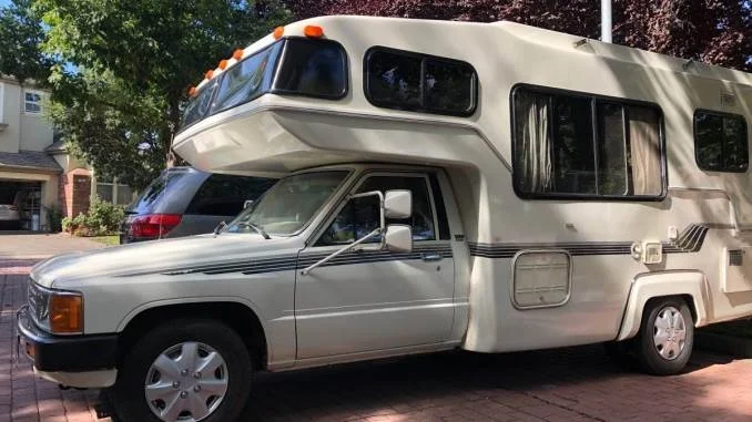

Sure, great for that! Toyota has built more than a couple of versions of campers, some even
with dually’s on the back - all powered by 22r motors. My buddy drove clear across Canada from
coast to coast. Averaged over 20 mpg with a dually camper. Slowwwwww…like any underpowered rig
stay right and enjoy the view. Last summer I passed a Toyota camper on the Alaska Hwy just south of
Whitehorse, both of us southbound. Just over three weeks later I’m at home on Vancouver Island and
by Victoria and I find myself driving right beside the same rig! I was home in four days. I bet it took them
at least seven. My only concern is radiator, cooling has to be preemo! Get head gasket and have the
head done proper.
