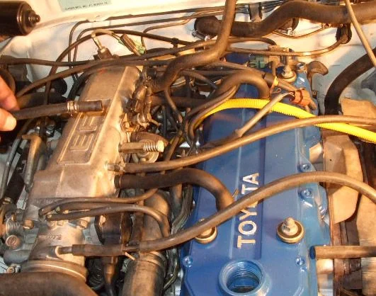

You may want to check this little thing here in the top pictuce but more importanty check what the idle up is connected to. The hose may be plugged into the wrong nipple. When it is warm the check valve may be pushing instead of sucking, etc.
