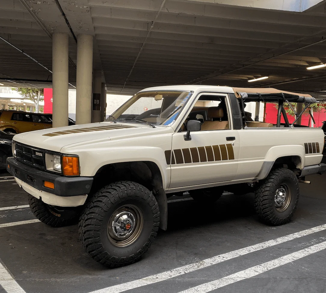

The truck now has 130000 miles on it. Maintenance records on the truck is lacking but it is super clean and I plan on keeping it for a long time hopefully.
Prior to realizing about the oil consumption I bought a timing kit because theres no record of that ever being done.
Looking for any experienced feed back on whether Valve stem seats are a thing best left to the pros or not.
As far as my experience goes on a 22re is Air plenum pulled and hot bathed, fuel injectors installed and flushing the cooling system.
The timing chain was going to be a new frontier for me.
Picture included because...
