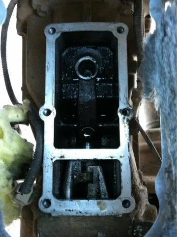

Recently replaced the clutch on my 89 yota pickup 2.4 litre and now my 4wd will not move at all, anyone??
80hilux said:Might sound stupid..did u adjust the clutch yet? Or does it not move when the engine is off also?
PAToyota said:Just 4WD? Or you cannot shift at all (transmission too)?
First thing to do is to bleed the clutch. Then the adjustment specs are in the FSM.
Could also be that you have the shifter in backwards. I know I did that once.
Just remember that 2WD is when the gaps form a square in the front.
