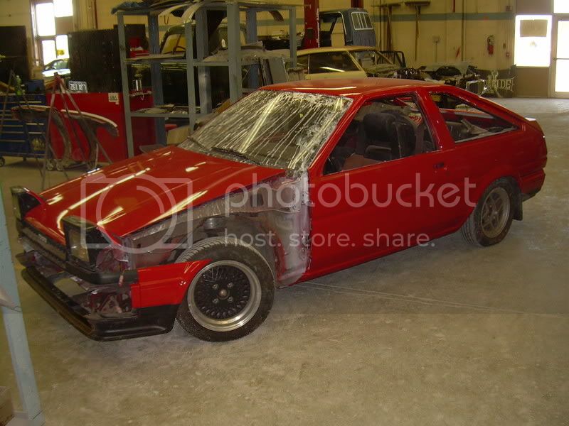

heres the reaons why I dont have more time/money for the P/U
