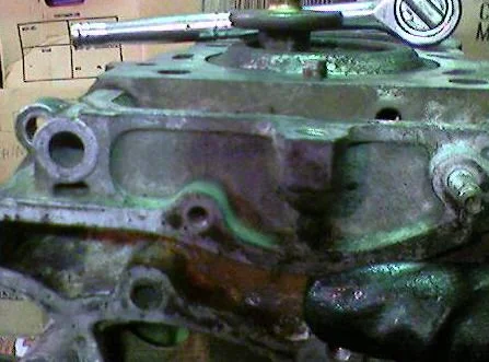

Here's a tall deck up to 85 block with an RE cover on it just for reference
attachment.php
