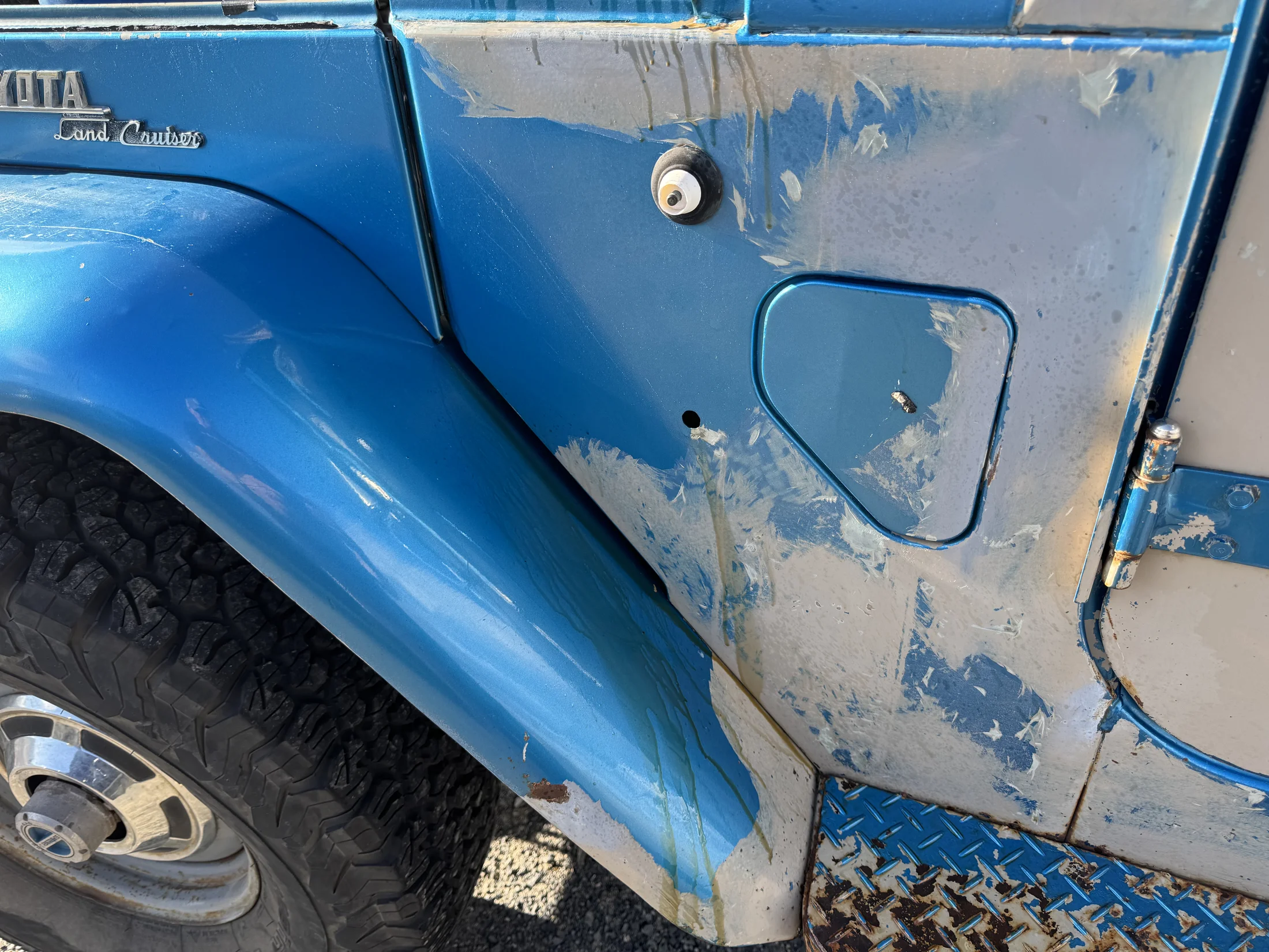

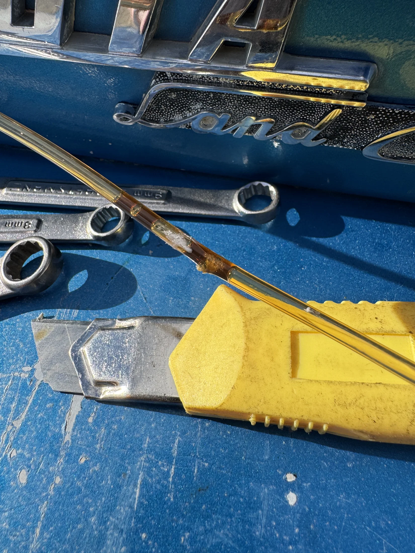

I was cruising down I-90 at 65mph just past Whitehall when I suddenly noticed the burro was creating a massive smoke screen. Like James Bond worthy. Immediately shut her down and coasted to the side of the interstate. Lifted the hood and found a pin hole in the plastic tubing for the aftermarket oil gage I installed a while back. It was spraying oil (at 50 psi) right onto the exhaust pipe. After deciding I-90 wasn't the place for the repair, I limped a few miles further to the Pipestone exit. By then I had lost a ton of oil. I had both the new and OE gage functioning. The new gage read zero while the OE gage did have some reading of oil pressure. I kept watching to make sure I didn't go completely dry. And coasted the last few hundred yards into the pullout.
So, I've screwed myself with the problem before, twice on my old ford. Same exact problem. Guess it takes three kicks in the butt before I learn. Thankfully I placed a T from the block to install the new gauge. So I pulled the T and inserted the OE gage back into the block. Problem fixed. Massive mess.
I coated our cruiser with 5 quarts of 10W-30. So, you know, I won't have to fluid film the driver's half of the cruiser. :rofl:

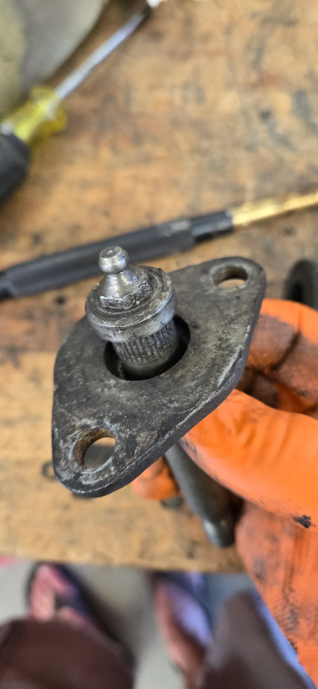

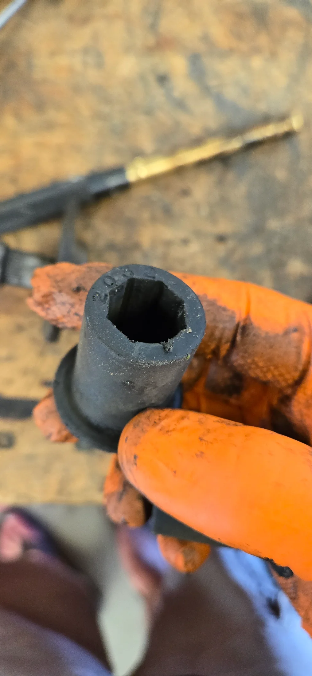

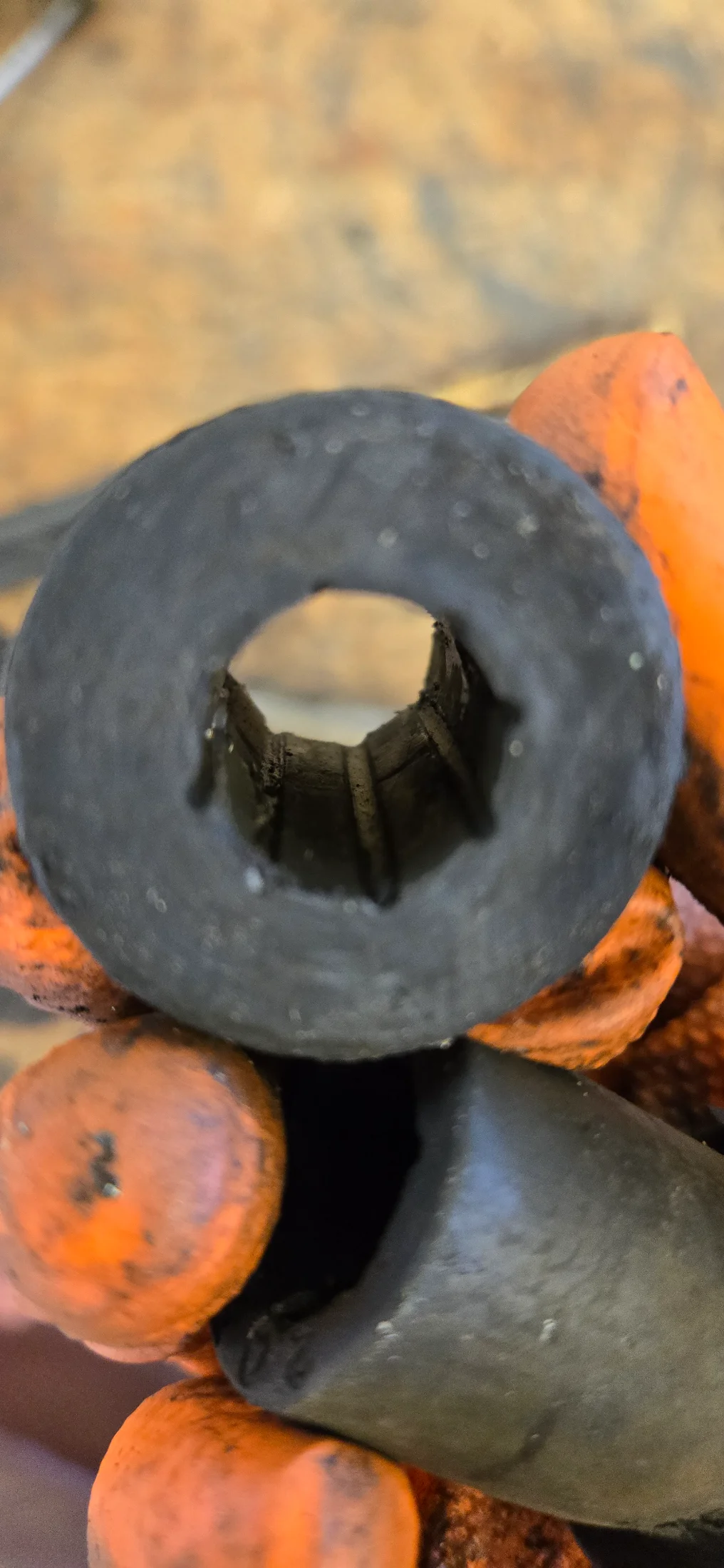

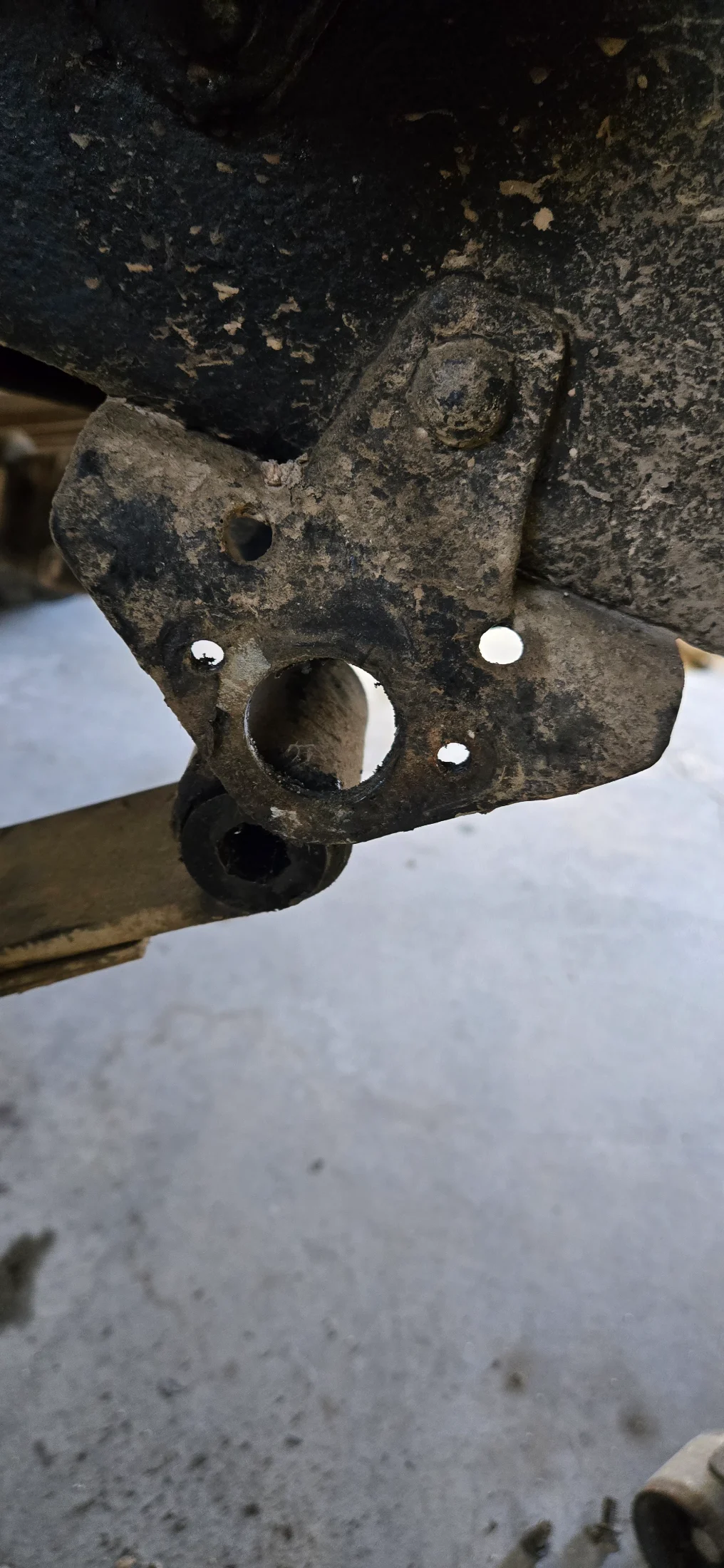

I may have found one of my knocks that was bothering me for most of the trip.
Grease would be a great help here. The grease in the pin was hard a rock. Another concern in the flange and the pin, the spliced section on the shoulder of the pin is a fuzz loose in the flange.
