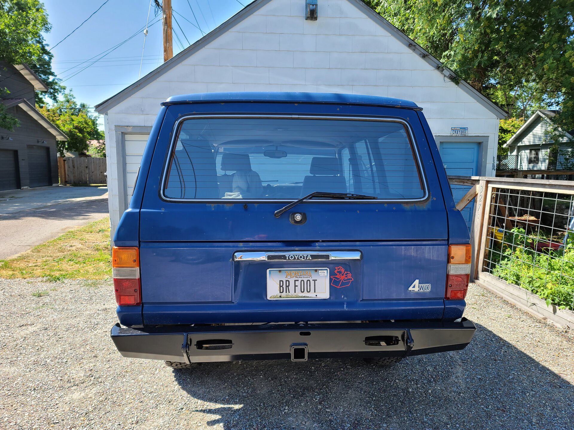

I second the 4Plus bumper. There is no lose to departure angle since the receiver is in the bumper.
I have installed the backup lights since the picture was taken.
That will actually improve rear departure angle since there's no hitch bolted below the frame rails.
