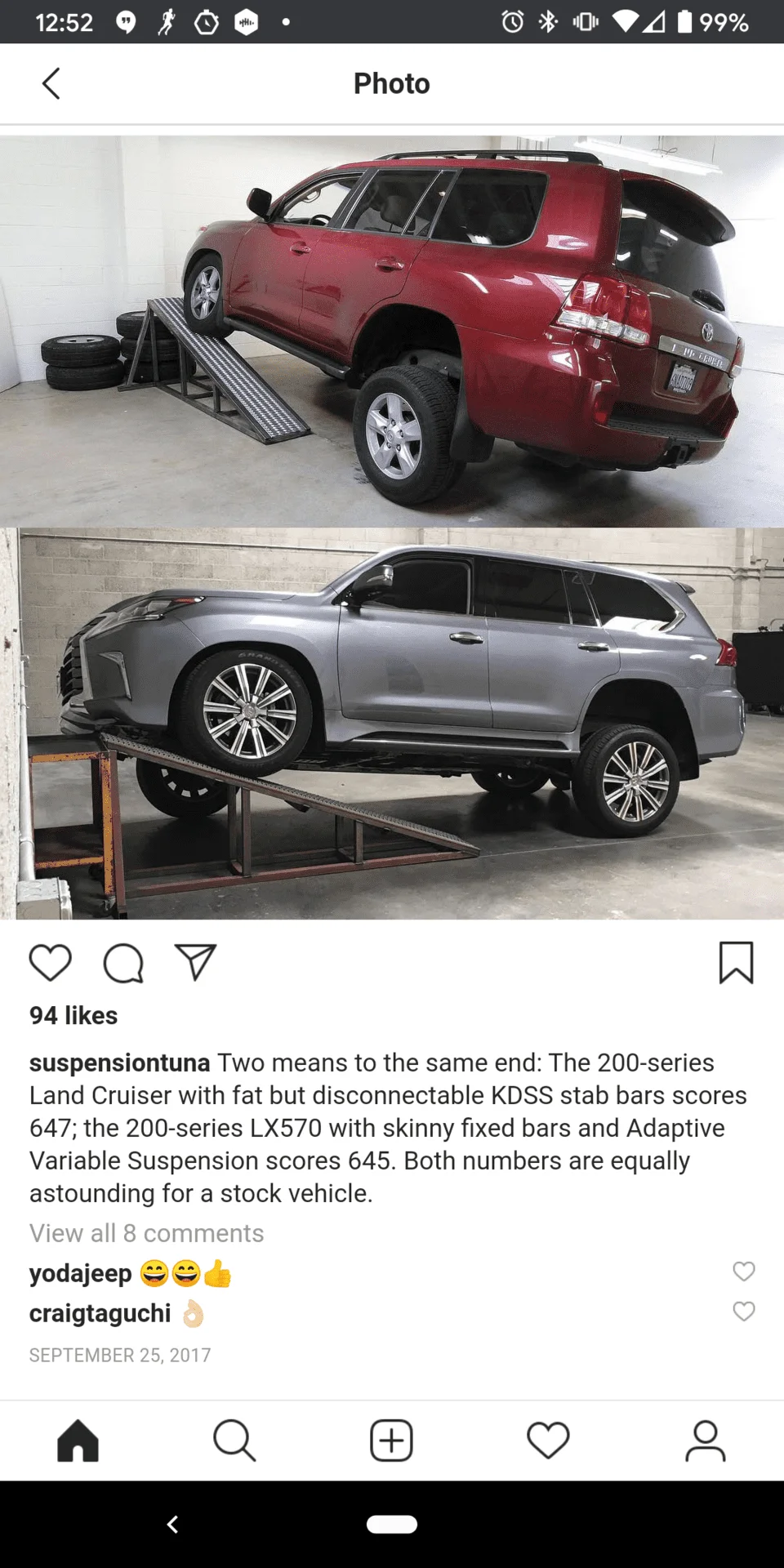

Dan (suspensiontuna) is also the dude who did the original test too back in 2017. With what looks like the same ramp equipment. He's keenly aware of the masked capability that exists in a non-sport LX. If you watch with that in mind, you can really understand his shaded commentary.
He was with a different employer back with the earlier test and he's looking to rebuild the RTI score board under the new employer.
Knowing the Land Cruiser HE that was tested here, if we assume everything else to be the same, it puts up a nominally better score than the past 647 of the standard LC. 661 to 647 can very well be within the test noise as it's only a 2% difference (~1.5" further up the ramp). It could also be the bespoke HE suspension which is suspected to be slightly taller but softer, perhaps aiding in this test.
I’m still trying to figure out whether HE has a thinner rear sway bar.. though I’m not sure if it even impacts flex on account of KDSS.
Either way, good stuff.

I was curious how much more vertical distance the LC HE 661 score represents over the previous LC 645 score. Working geometry backwards on a 20* ramp. Knowing it went ~1.5" further up the ramp.
Some quick trigonometry says the HE was able to lift its front tire .5" further in the air while keeping all the other tires on the ground.
Applying to real world, the massive RTI scores of the 200-series speaks to why I believe it wasn't offered with a locker. It didn't need it. Didn't need it to meet the objective performance requirements of the design. Keeping all tires on the ground means more positive obstacle clearing traction. With ATRAC and CRAWL further augmenting its capability. I've seen this flex play out in my own off-roading with mixed other vehicles.
Of course, we're always looking for that next level performance.

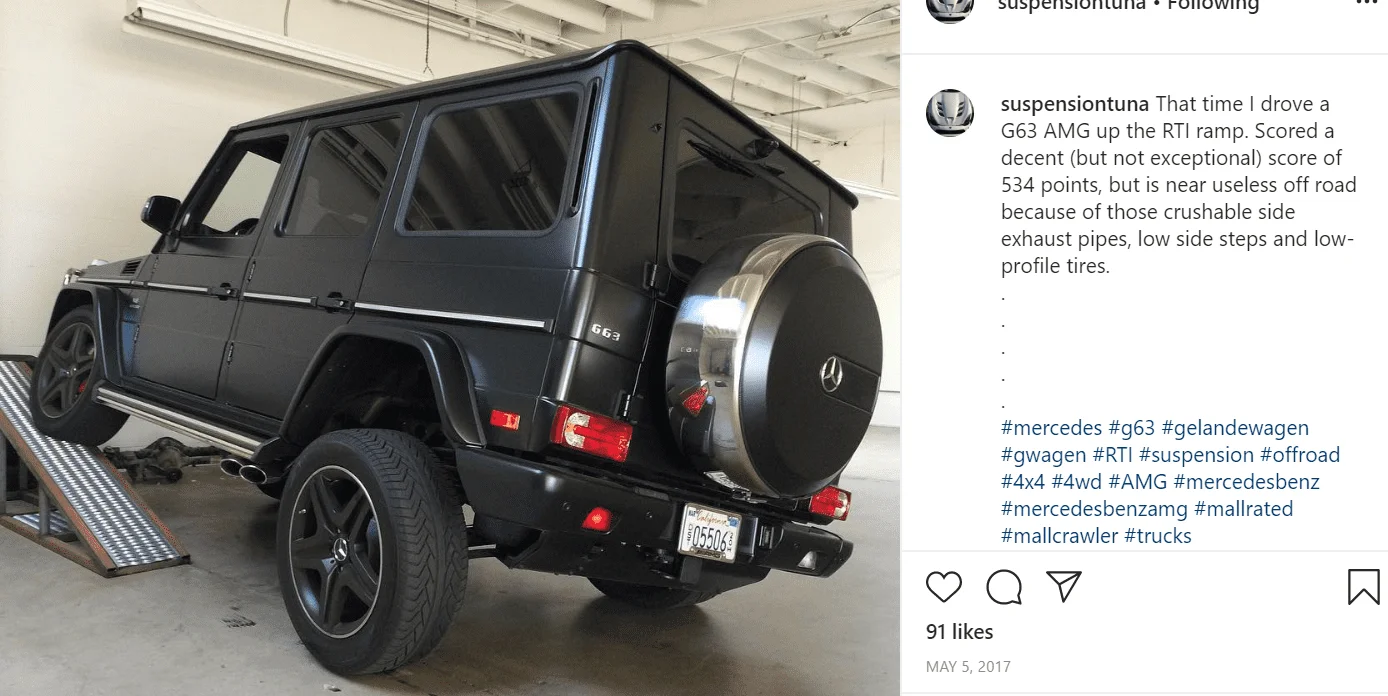

Old with SFA. Doesn't have purported legendary chops when measured this way.
I wonder if the AMG model has stiffer springs and/or thicker anti-roll bars??
EDIT: not sure about the new G-wagen, but the previous model used ridiculously stiff anti-roll bars due to its narrow track and super tall box design. I guess that this was the compromise Mercedes made to keep the tall G-wagen from just flipping over or losing control around corners.
The new G-wagen is wider and has IFS...and supposedly has better suspension travel than the old model. So it will be interesting to see how the new model flexes.
