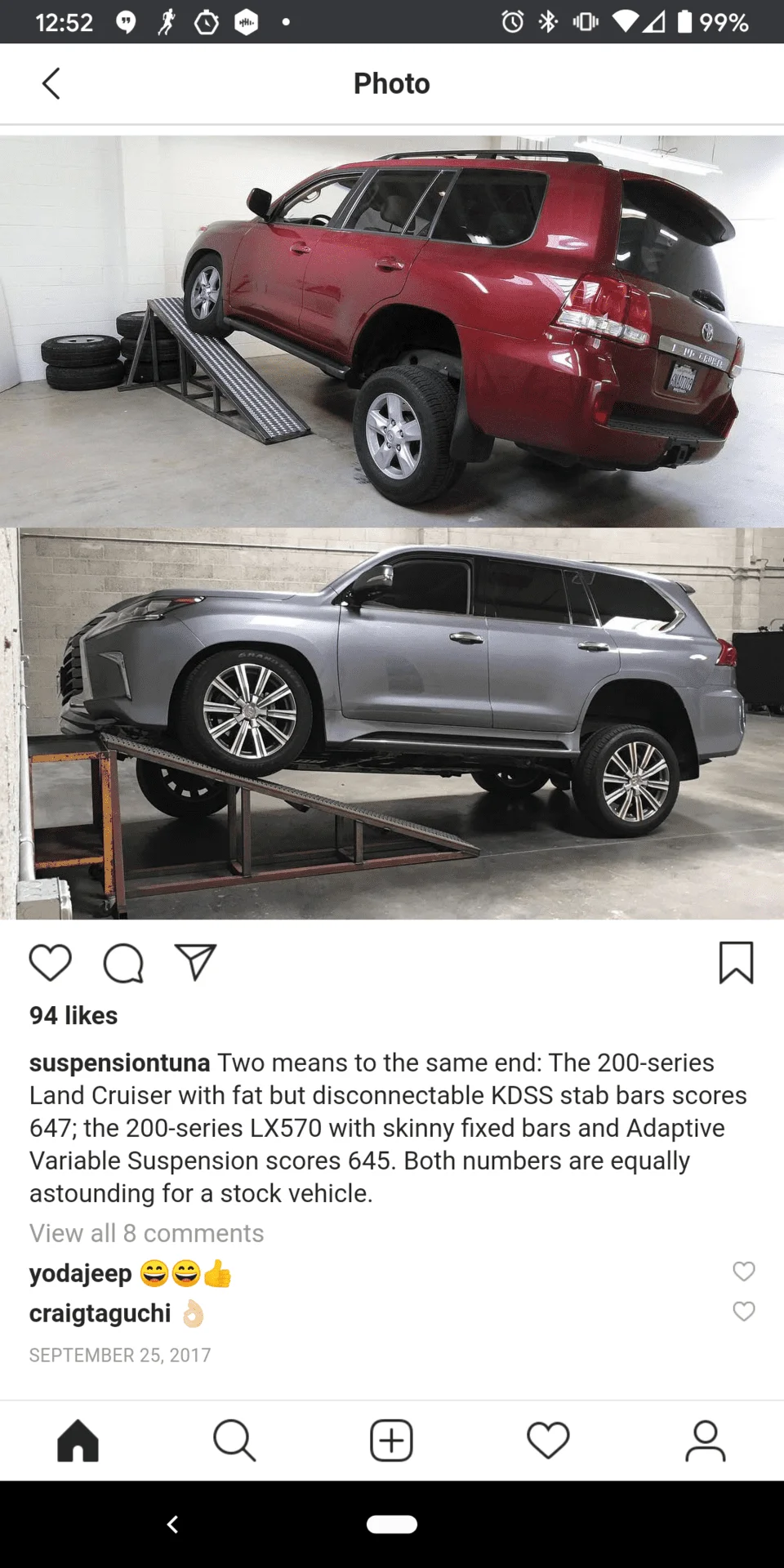

I wish I had a ramp like that to test the writer's theory. This might explain why in some tests the LX RTI closely matches the LCs but on others, like this one, it's lower.

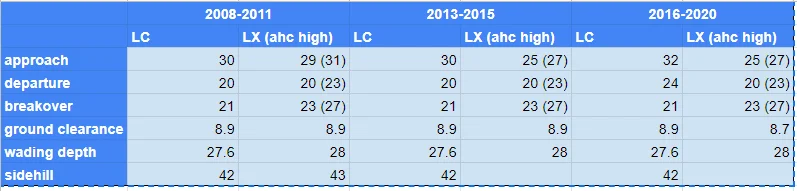

TeCKis300...the data on that table you made about clearances makes no sense, conflicting data points.
Just because you don't like it doesn't mean it doesn't make sense. Feel free to provide references. Just as we discussed weight the other day, there's many variables here that you are may not be fully grasping. I know there's some mis-matching data provided by even the manufactures directly, including for the HE. My goal is to distill it down to something useful - despite the sometimes overly simplified data out there without supporting details.
Conflicting data points is NOT me “not fully grasping” anything. They are unreliable pure and simple.
For example, your table shows that 2008 LX has same approach and departure angles as LC of same year, right? Given that both have same tire size (just different rim size), same wheelbase, same underbody......why is the breakover angle so much better in the LX (even in NORMAL mode)??

Lift prioritizes clearance. It's asking the suspension to be up on stilts. You can see that the driver side front wheel on the LX, is keeping the tire from full compression - to maintain clearance priority for the sport chin spoiler. Clearance is sometimes at odds with articulation which you can clearly see here.
You can also see from the test I posted, that normal height brings back comparable articulation. Giving up clearance. With a push of a button, choose your poison.

Even in stock HI mode, clearances of LX is not any better than stock LC yet it has worst articulation.
Aftermarket mods are one thing...stock suspension is another.

Breakover angle How Break over angle is calculated. The inputs are ground clearance and wheel base. If location for measuring ground clearance differs then you can have differing values.
I still think some of those numbers were entered by a pimple-popping cross-eyed kid at some Toyota marketing center.....

Well, this is about articulation. In NORMAL mode, LX articulates amazing, easily on par with LC...as evidenced by Edmunds' test. But in HI mode, LX articulates significantly less, mostly at the front IFS...as evidenced by Autoblog article above.

It would be even more useful to bring a non sport package LX to the party. The model trim is OBVIOUSLY introducing an unnecessary complication to the comparison. The fact that the comparison was then made to an HE is also OBVIOUS. The result is great for blogging, but not particularly fruitful of a comparison. Just get a normal 2020 TLC and normal 2020 LX570 and run it again. Which will result in . . . . the results posted above. Which are essentially identical 647 to 645. I also view the 661 as within error range of the 647 result, different HE rear end or not, it only 14 pts, which is 2%.
If H mode comes with a 10% penalty, that is a shame. Of course, it would need to be compared to a 2 1/2" lifted TLC to see that RTI as well . . . And then you can't compare that same TLC to the LX in Normal mode, because you can't unlift the TLC.

Gladiator Rubicon with front swaybar disconnected 607. Without disconnected 458.
Wrangler Rubicon with disconnect 693
Same ramp and assume same blogger.
