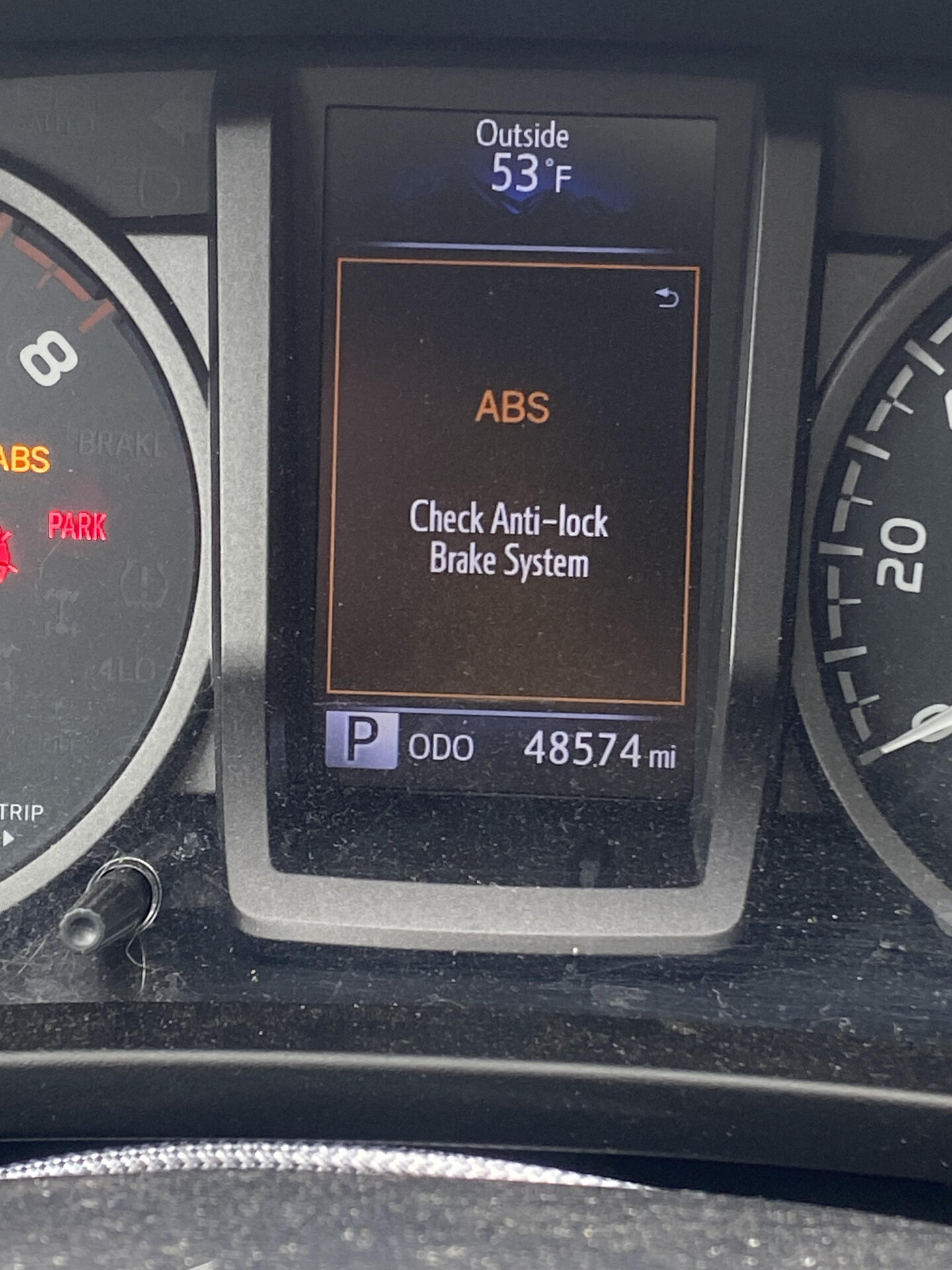

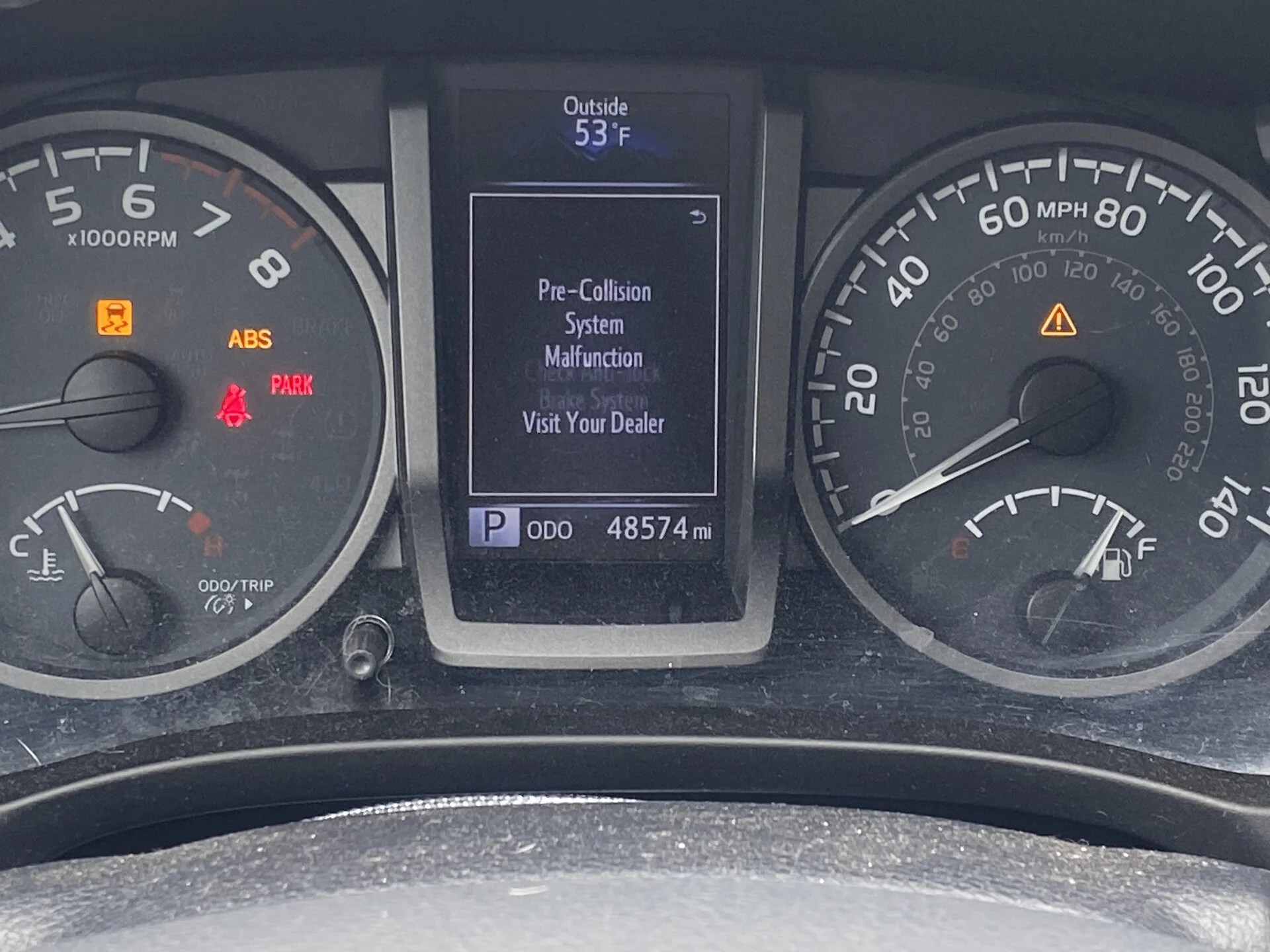

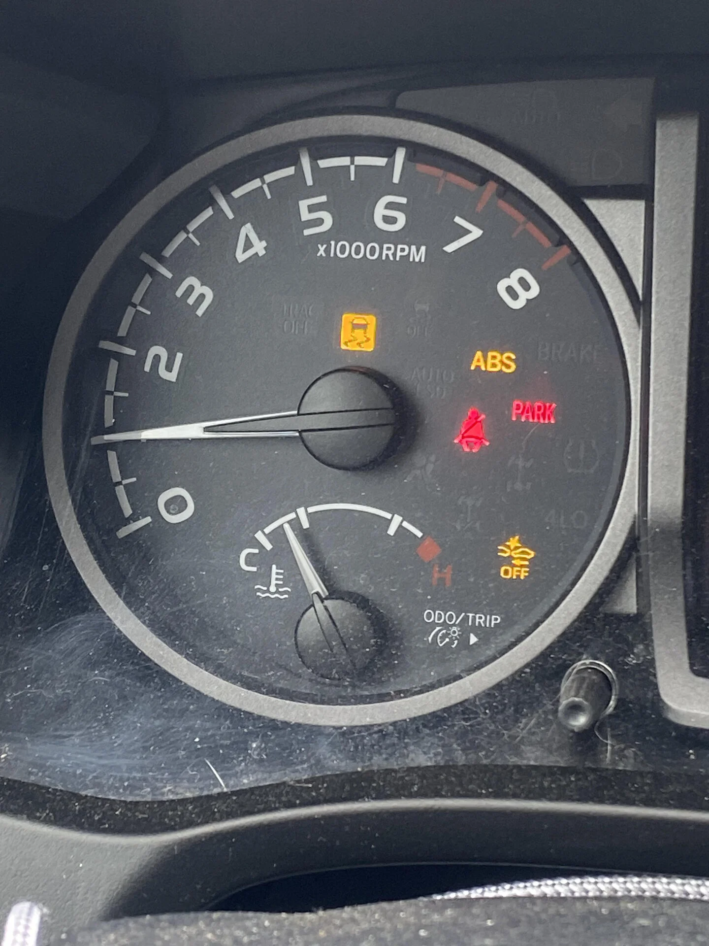

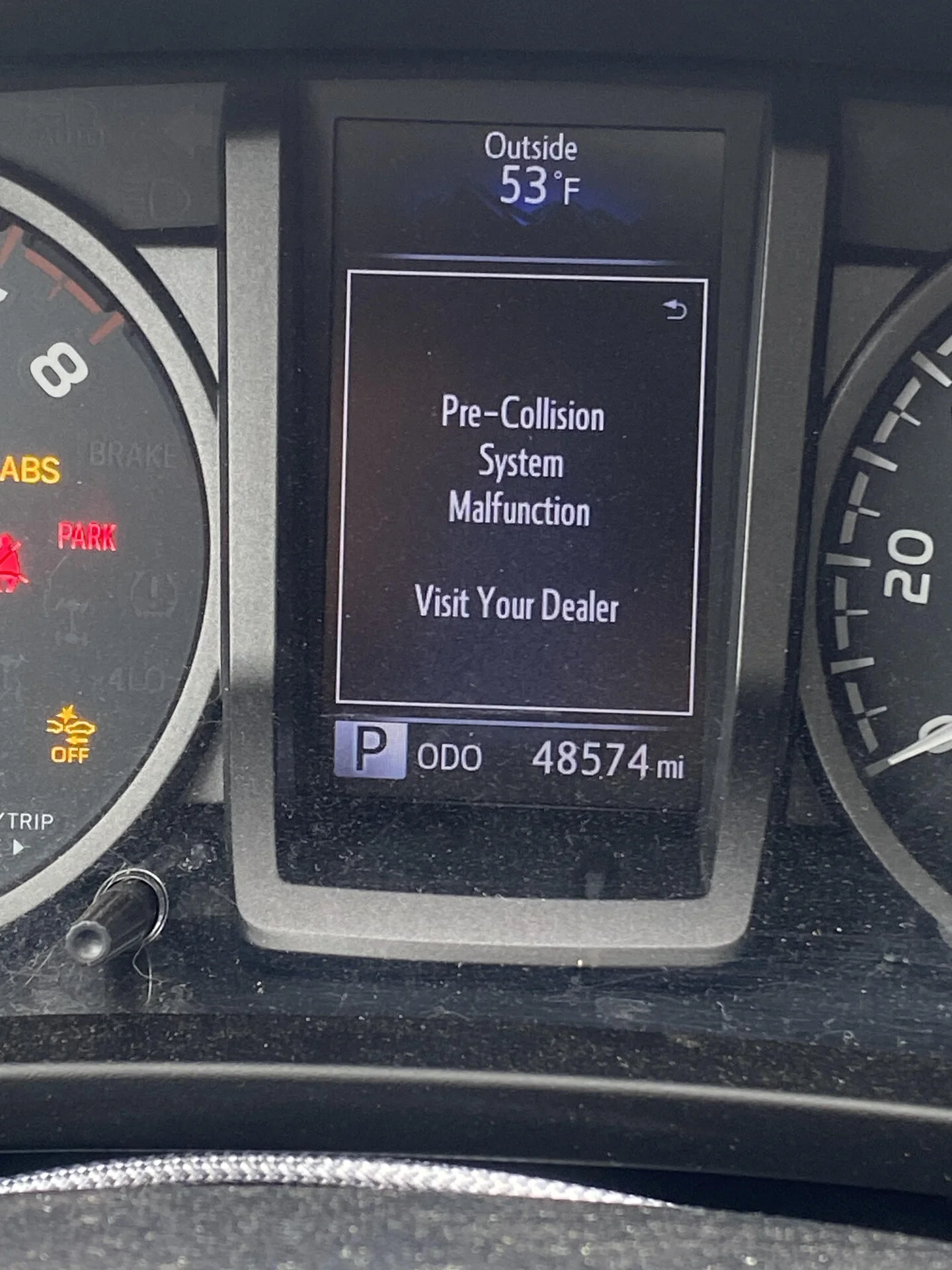

Hi, all! I've been trying to research this issue for months and I've run into nothing but dead ends. A bud of mine recommended these forums so here goes:
I have a 2018 Tacoma TRD Off Road with Pre-collision System (PCS). My 2017 Tacoma TRD (without PCS) was totaled last year. I was running these on the 2017 without issue. I pulled them off of the 2017 and put them on my 2018, and the errors began to fly once the headlights/tail lights were turned on (photos and video link below). To rule out any kind of electrical jostling as a result of the accident I bought this set. Same issue.
The truck would run fine until sundown/low beam headlights and tail lights were engaged. Once engaged, the truck would lose acceleration power (pedal to the floor and nothing would happen until completely depressed, then it would reset and acceleration became possible again). An ABS and PCS error would flash as well. Occassionally, the truck would be thrown into limp mode as well which was bizarre.
1. Has anyone else experienced this?
2. Is this a known issue with later model Tacos with PCS?
3. Has anyone found a work around or after market LED tail light that is actually compatible with a 2018 Taco with PCS?
Video link (it's a temp link, sorry guys): iCloud - https://share.icloud.com/photos/08e-Vnrirum3vFGtMRHS2YarQ
