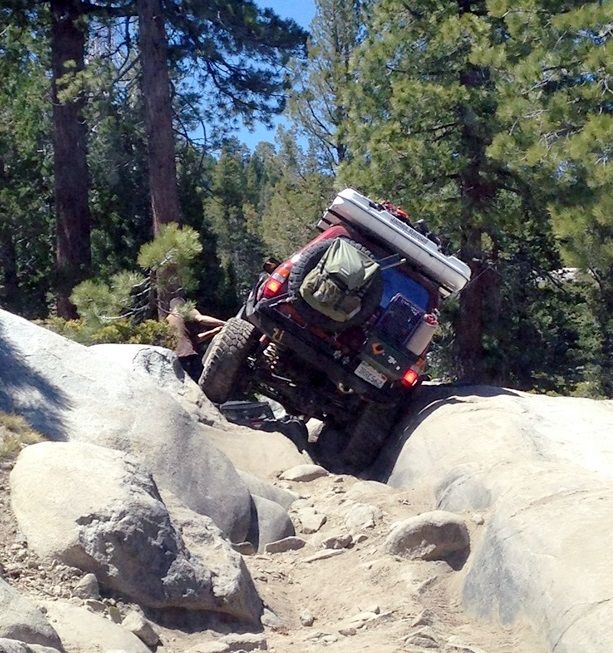

For those that have done it, would you recommend against a RTT. Not sure if this creates additional clearance issues, or specific obstacles that would make it more tippy? Trying to decide between the RTT or just a normal tent.
This will be on 100 series, with 35"s, and 2.5" lift.

I have never been through the rubicon but my plan for running it is to take my RTT off my 80. I just don’t like how too heavy my truck feels with it. My RTT stays on my rig full time but coming off for RUBITHON

I ran a Tepui Kukeman rugidized last year on my 80 for rubithon and while it was cool and made sleeping comfortable I will never put a roof top tent on my truck again. Way to tippy for my liking
Thanks I was thinking that may be the case, just wanted confirmation.

it's not that tippy...bring the RTT, beats raking out granite from under your hip, besides, it's faster and uses less real estate for camp. only 'sposed to be 100 feet from center of trail, remember... or is it fitty?
