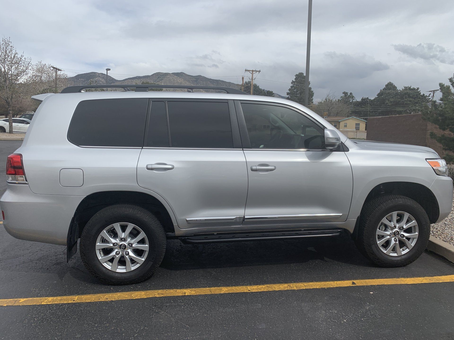

Hey guys. I’m new to the forum.. picked up a 2018 a couple of months ago. I’m in the process of throwing some mods at it now...
I was having the lift installed by a local 4x4 shop and they accidentally let some pressure out of the KDSS. I initially warned them and printed out ARB’s KDSS instructions but the tech mess up.
They installed the lift and lowered it off the lift and all seems okay.
I’m not sure what I should be looking for as far as problems. It seems to drive fine. No warning lights. No excessive roll.
They said if things were messed up they would pay Toyota to correct them.
What should I be looking for?
Thanks
Jason
