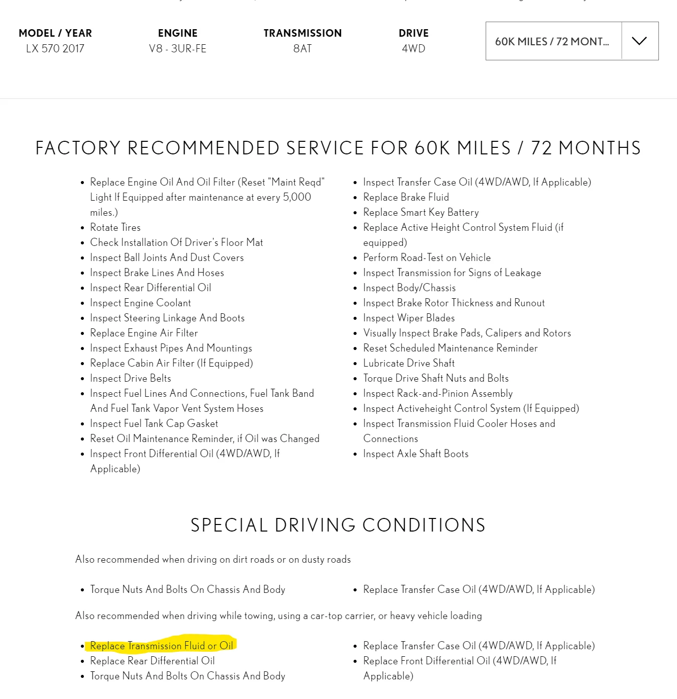

That's weird. If I go on the owner's website and look at the maintenance schedule some of the intervals have an option to "Replace Transmission Fluid or Oil" if the vehicle has been towing, using a top-carrier, or under heavy load. That would lead me to believe it can be done so someone somewhere is in error.

The Lexus dealerships I've called don't know what the active height control fluid is and certainly I have been explained how the transmission fluid is a "lifetime" and they don't replace the transmission fluid. My understanding is that lifetime is warranty period and their bet is wait for transmission issues for higher paying service. If anyone knows a shop in Houston area capable of replacing the fluid do let me know. I would hate to perform myself since the overflow valve requires some specific temperature, I know there is a workaround to connect a wire within the OSB connector and moving the shifter, but it seems super primitive.
