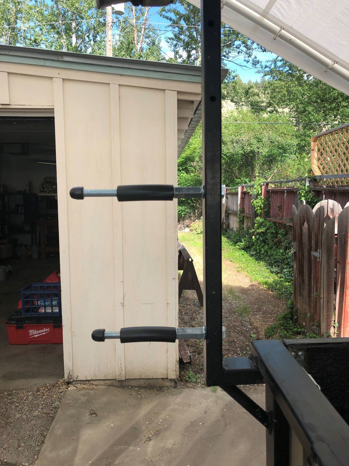

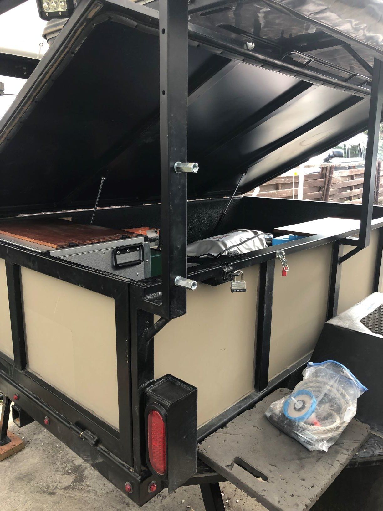

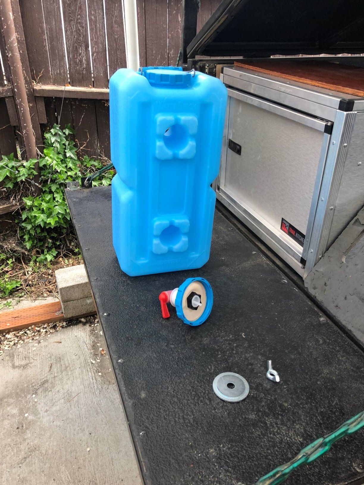

My current water system is simple and consists of eight 3.5 gallon Waterbricks which calculates to 28 gallon capacity. I ordered a spigot with them and thought - wow, my only issue is going to be switching the spigot to the next Waterbrick as I drain them. Wrong......what I didn't realize is that setting on their side, with out tipping it, you can only drain out about 1/2 of the water. So.....back to the drawing board. Somehow I came to the conclusion that If I could hang the Waterbrick upside down, I could drain 95% of the water out through the spigot. At 1st I used a rope strung through one of the holes. Then I remembered the transport holding plate I had made out of plywood and threaded rods. I thought if I could find a spot to mount the rods vertically, it might work. Well, I didn't have to look far.....the same spot on my trailer had a vertical support to mount to. The following pics illustrate my solution.
Drilled & bolted on thread couplers.
Add threaded rods with rubber hose and plasic caps to protect Waterbricks
Remove transport cap from Waterbrick and replace with spigot
Spigot installed. Nozzel can be rotated 360* after installation to point in direction needed.
