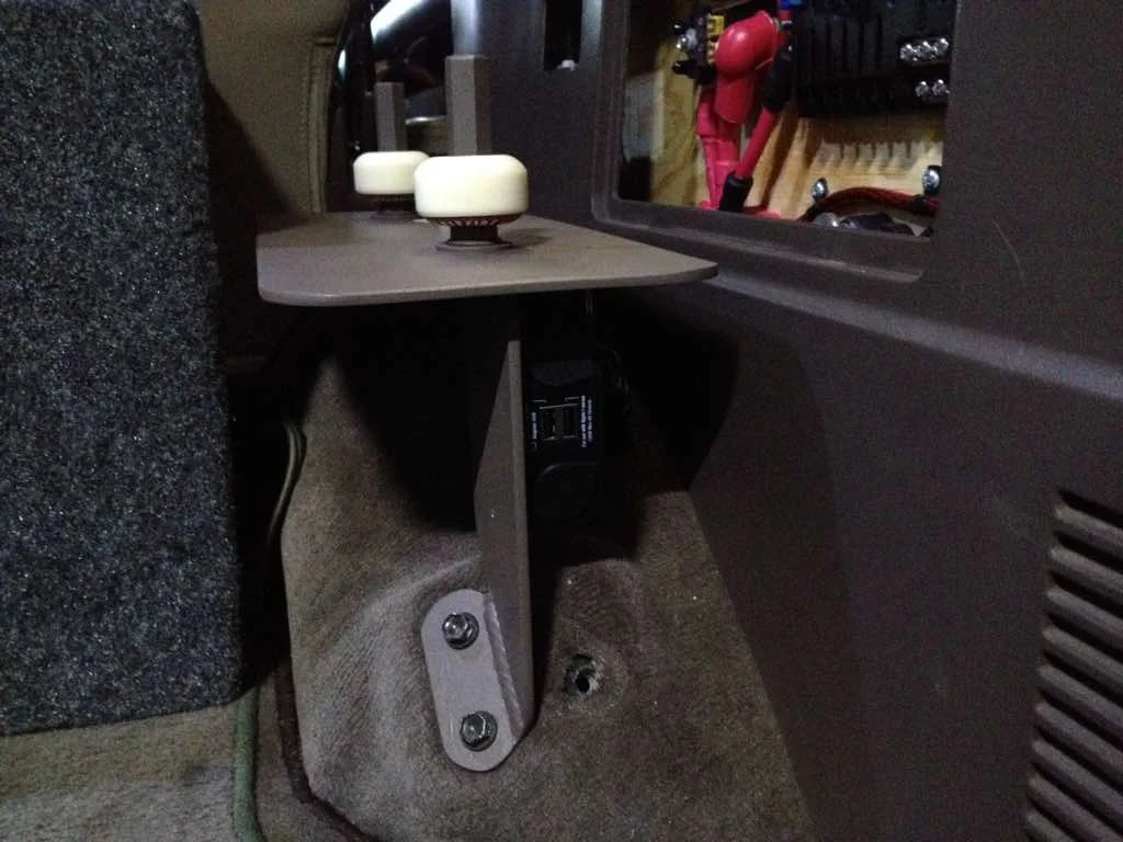

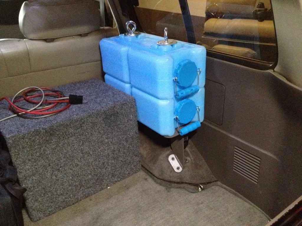

Here's my LandcruiserPhil Puma mount modified to hold two 3.5gal Waterbrick containers. This mount, on the passenger side, works perfectly for this given how the mounts are nearly centered underneath the platform. Each fill Waterbrick weighs 28lbs according to their web site. That's the same as a Puma compressor. Two are right at 56lbs. included hardware brings it to 60lbs.

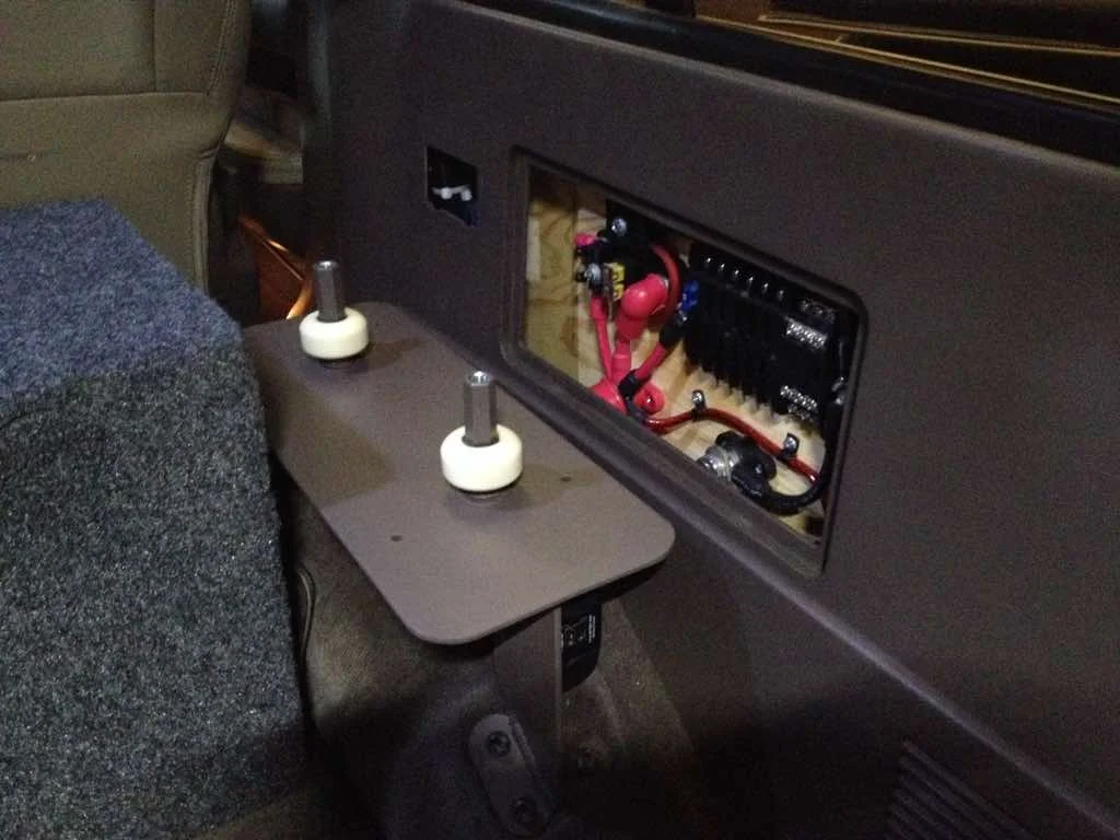

I've devised a stud and retainer system to keep it from moving laterally or vertically without placing any stress or abrasion on the containers. I can also access my storage area to get to my wiring distribution point unobstructed.
The studs are 1/2" bolts, misc. nuts, connectors and 50mm urethane skateboard wheels. These easily hold a single Waterbrick without vertical hold downs if need be. The skateboard wheels are placed vertically to center inside the tapered cone shaped holes in the Waterbricks.

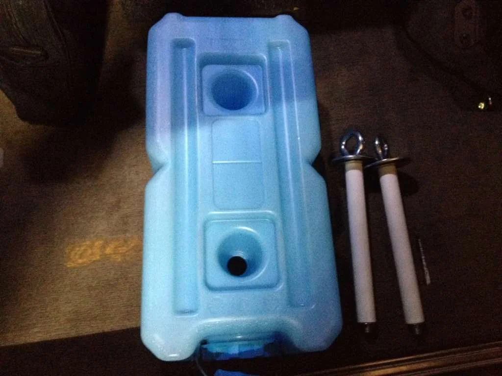

The hold downs are 12" 1/2" eye bolts inside 3/4" PVC and a series of washers to form a 3" hold down on top. These hold downs are configured to tighten to the studs and stop without crushing the Waterbricks.

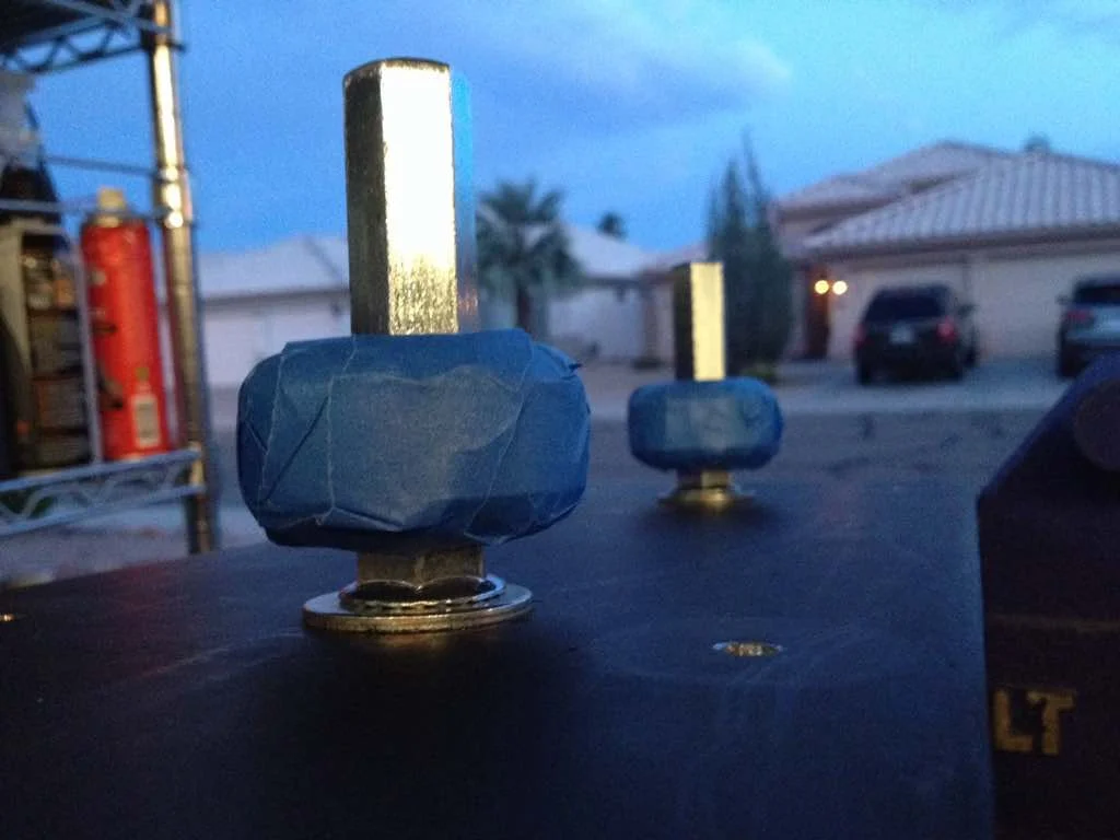

The studs start with a 2 1-2" x 1/2"-13 bolt with a lock washer and washer coming up from underneath. On top of the platform is a washer and flared lock 1/2"-13 nut followed by a standard 1/2"-13 nut which locks everything together.
Next the 50mm skateboard wheel goes on and pushes down over the nut. The urethane is soft enough that the nut will form into the wheel. Next a second standard 1/2"-13 nut goes on top of the wheel and will squish down far enough that you can't gets wrench on it. Just turn the wheel by hand and everything will tighten up. Finally, put the 1/2"-13 extended coupler (long nut) on with red Lock-Tite and tighten securely. The coupler will tighten the nut in the wheel. Repeat for the other stud.
I masked the wheels, sanded the new hardware with 80 grit and painted everything with 2 coats of primer and a few coats of Rustoleum Textured Bronze (7226) for a perfect Oak color match.

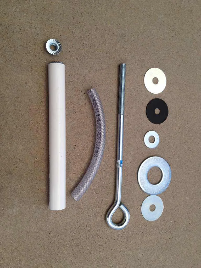

The hold downs are 12" X 1/2"-13 eye bolts that begin with a 1/2" fender washer followed by a standard washer that fits inside of a 4" x 3/4"? washer to center it. Next is a 1/2" rubber fender washer sized washer as finally another 1/2" fender washer. It would have been easier to find a 3" or 4" washer but I couldn't locate one at Ace Hardware.

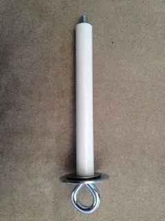

I then cut a piece of 3/4" PVC at 9 1/8"" long and used a rounded wood rasp to enlarge one end slightly. Within this end I inserted a flared 1/2"-13 nut backwards and tapped it in until it was flush. I determined the length by placing the Waterbricks on the studs and dropping the PVC with the pressed nut through the holes until it touched the extended coupler (long nut) then marked the PVC where it was flush with the top of the Waterbrick.
I slid a piece of 1/2" hose over the length of the eye bolt to keep everything centered and to retain my stack of washers. Next I screwed it together snugly and marked the first thread protruding from the nut with a sharpie.
I removed the PVC placed Red Lock-Tite below the sharpie mark towards the eye of the bolt and then slid the 3/4" PVC over it and screwed it snug. This secures everything and leaves clean threads with no Lock-Tite exposed.
The hold downs now screw into the studs until they stop, no need to be over tightened from what I can tell.

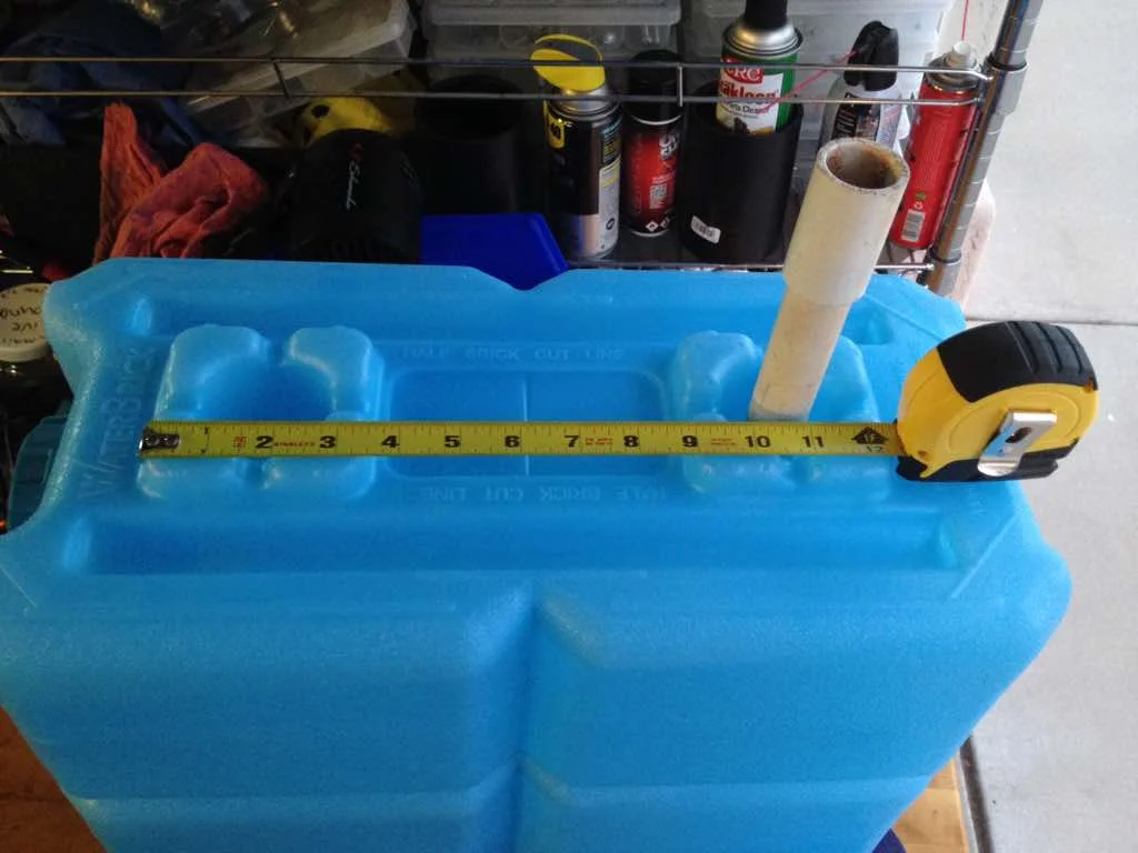

Oh, I almost forgot to tell you how I figured out where to drill the hold down holes. Doh!
I stacked 2 Waterbricks on the Puma mount with it bolted onto the fender and took a piece of 3/4" PVC and inserted it though each hole in the bricks. Once I was happy with their placement, I just twisted the pipes and they made a perfect circle marking to drill into the center of.
The bricks are exactly 18" long as the shelf and only slightly wider.
