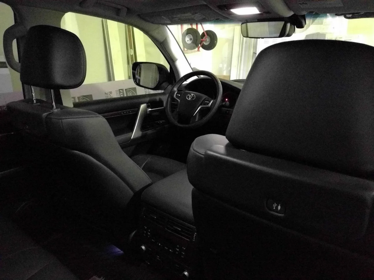

I had the same feelings about the screens. They are easy to remove. Pop off the plastic cover at the mount, remove three obvious nuts and unplug two wiring harnesses. I also had a custom interior shop near me create a cover with USB ports.
Wow! That looks great! Care to PM me your guys contact?
Nicely done, looks like a professional finish and you have removed the unsightly and amusingly bizarre monitors. Do you mind sharing the shop who make inserts for me to also order? I have been thinking about this problem for a couple of months now...
Thanks,
Peter
I'm itching for a 2017 and hate those screens. Please send Details on the screen removal and the new covers with USB if possible.
Ok. There appears to be some interest in this. The process took a bit and I needed to leave my truck at their shop for a week or so.
I'm going to contact the guys that did this and see if they can pump out a batch that can be easily DIY installed. They can use my truck as a base. I'm not sure if the USB option will be that simple to DIY but they maybe with a bit more noodling they can figure out a plug and play there too.
Give me some time and I'll repost.
Thanks for your help on this .... is that a GS in the background? I am on my 4th R1200GS and love the off road riding!

I hope the screen hole covers can be made available, even if without USB ports. I'm considering a '16+ and the first mod would be removal of those humorously awkward LCD screens.
