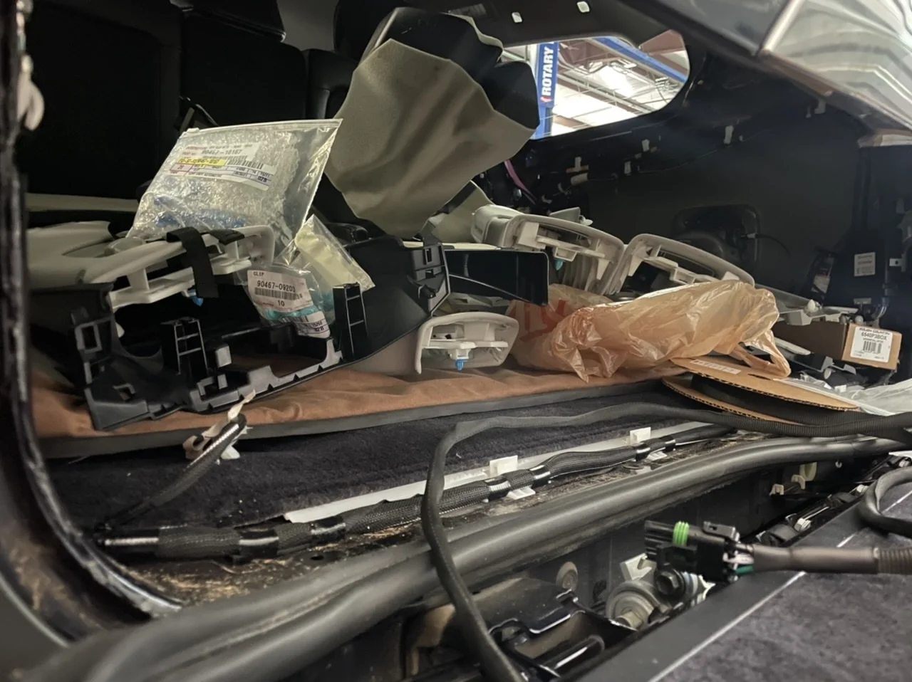

The install isn’t final yet. Should be completed this week.
The main issue was that Prinsu provided direct instruction to my shop that this was a simple “bolt on” mod and would not require the headliner to be dropped. Which has turned out to be patently false.
My shop also ordered 200LC rubber trim to fill in the channel left behind by removing to OEM Lx roof rail. That was not included as an option in Prinsu’s parts or instructions. When asked about it, they just said they left that channel open and uncovered- which in the opinion on myself and my shop was a great place to collect water.
We’re too far down the road now to change - but the whole thing to date seems like an R&D failure on the part of Prinsu / CBI.
I have confidence that my local shop will see that it’s installed correctly. But at the end of the day, they misquoted the required labor hours to install based on direct input by Prinsu.
At the end of the day, this is far more than I would have wanted to take on as a backyard wrench project and I’m glad my local shop has such highly competent people to see this through.

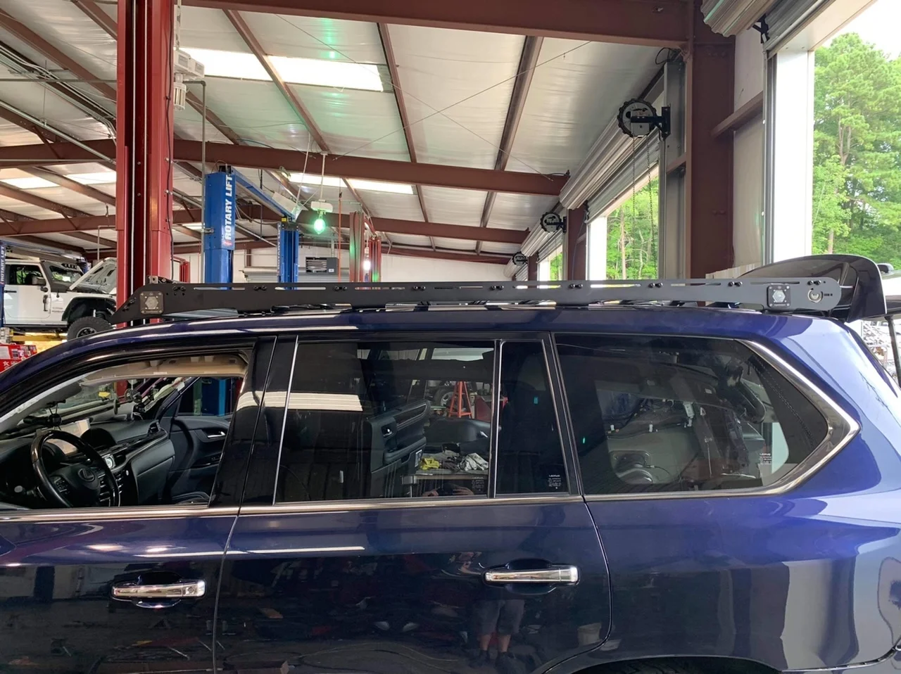

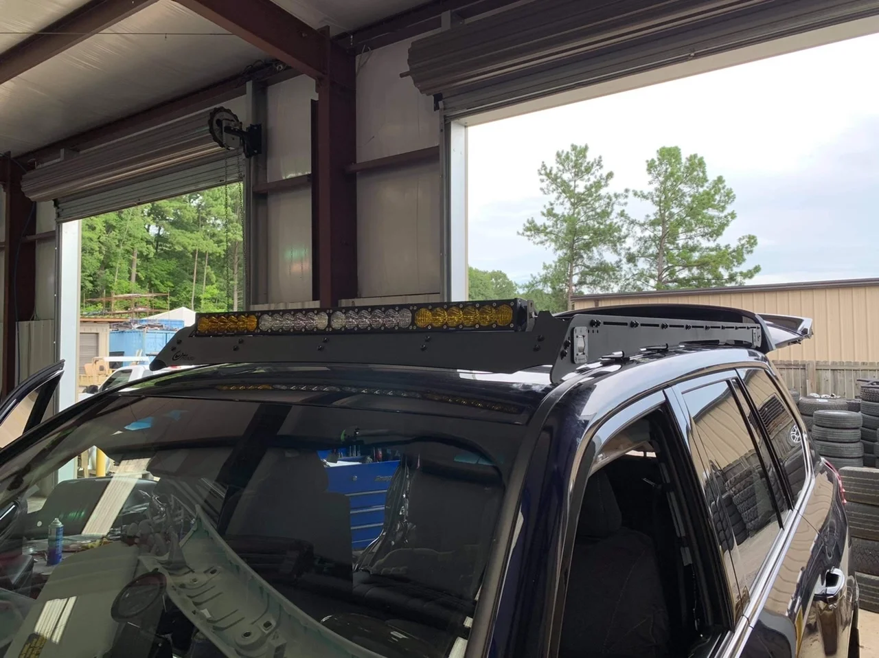

Update from today. Rack test fit. Rear spacers need to be adjusted slightly.
The shop modified the rack to accept four flush mount Baja S1’s.
View attachment 2723962View attachment 2723963
Looks good!

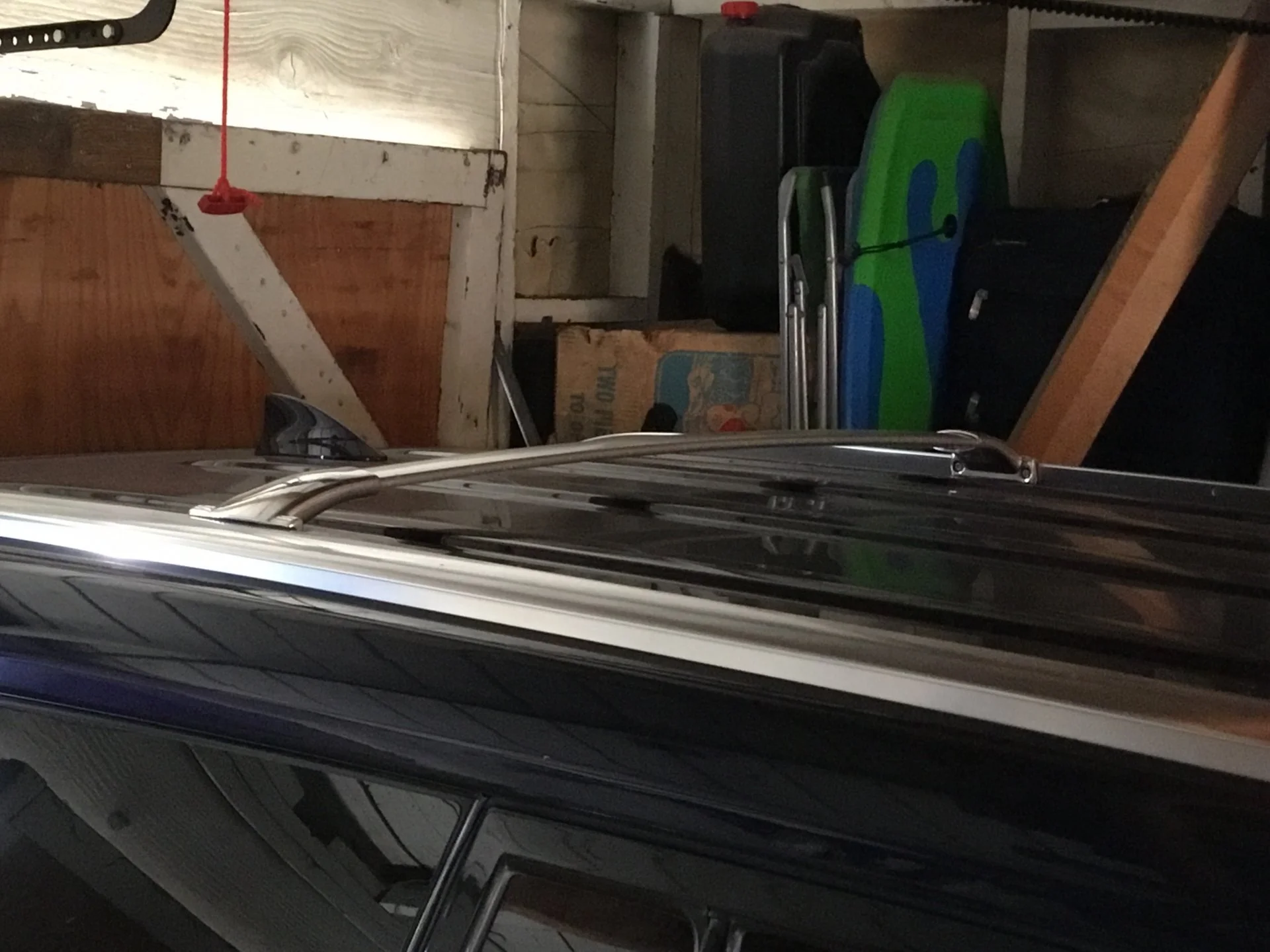

Here‘s what I have on mine now, but I’ve also got 2 other solutions with the ”best”, for now, being a Thule setup that I haven’t even test fit yet. We have a large Thule car top carrier that we used to use on our series 80 and aside from that, I may want to occasionally carry Home Depot kinda stuff (lumber, long things, etc.). Other that switching to 18” LC takeoffs, our LX is stock.
First ‘solution’ was getting some LC racks. Installation would have required dropping the headliner. Then I saw the crossbars (above) and thought, why not? Got them and was set until I happened to watch a YouTube video about a fellow that picked up a RTT and put it on his rack for transportation to another location. What scared me was that as he drove and picked up speed, the wind traveling under the RTT started to LIFT it! He had to attach a strap to the front of the RTT and hold it down (through the sunroof opening) with one hand while steering with the other. There were better hold down solutions but the message was clear, there can be lift at speed.
If you look closely at the far end of the crossbar, you’ll see two allen head set screws that extend into matching depressions in the factory side rail. This is fine but my paranoid self saw the possibility of disaster if enough lift is created under my car carrier at speed. Sure, maybe not likely but the search was on for a “clamp on“ solution that‘s more secure. Hence the Thule setup. A bit pricey but very secure. Will probably remove when not needed.

Another Blue LX!
Are those crossbars OEM? I thought they came in black. They are nice and low slung.
My only issue with them other than the price is where do i strap to laterally? Since its touching the body, there is no gap to fish through.
Looking forward to seeing your thule setup.
I’ll look for the same or similar crossbars. They are aftermarket and I believe that they are made in China. It’s funny, I could have sworn that I got them from eBay but the transaction doesn’t show up in my history.
How do you strap laterally? I guess that you can only strap to the crossbars. All the more reason to have a robust system like the Thule system or an aftermarket rack, period. But then there are the associated things like installation and cost.

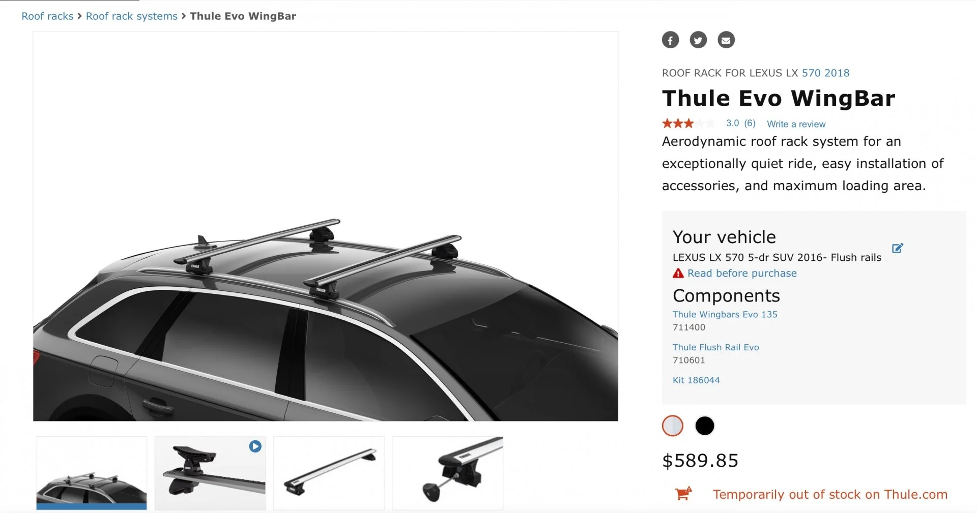

I’ll try and find a picture of the Thule system that I went with. Might be some time before I can get it “test” installed on my LX. Everything is in storage and too many to do things on my plate right now. The Thule system was close to $500 IIRC.
