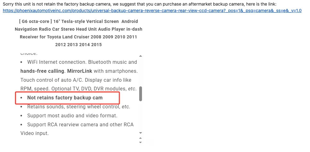

This link is great. I'll try that out and update you. Meanwhile the support from Phoenix mentioned that they don't support backup cam.
