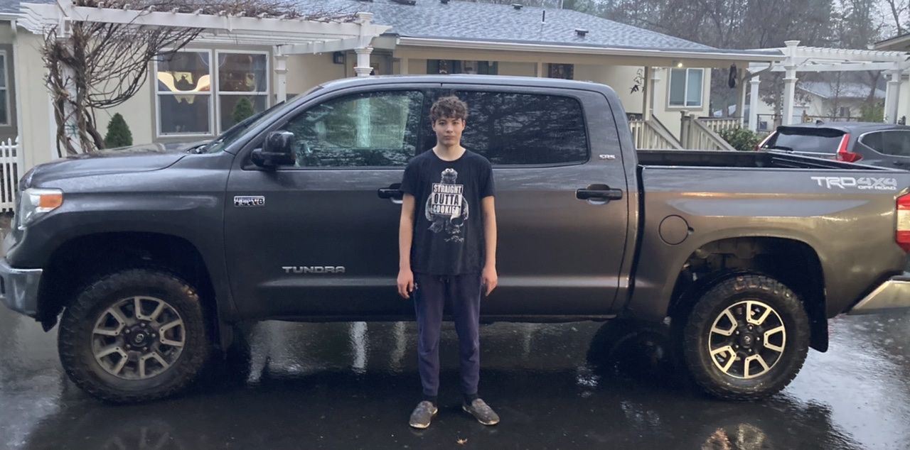

I finally pulled the trigger on the OME lift. Got the 612 springs since I don’t have a bumper or plan to get one. Added the UCA’s so I don’t have alignment issues. Looking forward to regaining control of the Tundra. FWIW, 170,000 miles is too long on the stock trd suspension.
Tomorrows project is to pb blast the nuts & bolts. Also need to take before pictures.
After having truly crappy lift blocks over the stock Rock Warrior springs & broken Bilsteins (I have a thread going) - New springs & shocks are a night & day improvement.
I’m thinking fresh LCA’s w/ those Total Kaos strength tabs may land on the truck before I go nuts on Icon shocks out back - maybe pick their brains over different leaf packs too / replace whatever Pro Comp junk is in there.
FR strut swap is a straightforward thing - the 4 bolts up top & single one on the LCA.
GL !
Got the install done today. Ride is much improved and the truck is now much closer to level. Handling is night and day better! Install went very smooth with the exception of the lower shock bolt on DS. Not sure what the deal was but the bolt would stop half way through the bushing where the threads ended. A Dremel sanding disk and wire brushing the bolt coating off got it done. Gave the bolt a good coat of moly grease hoping to give it a little protection.
