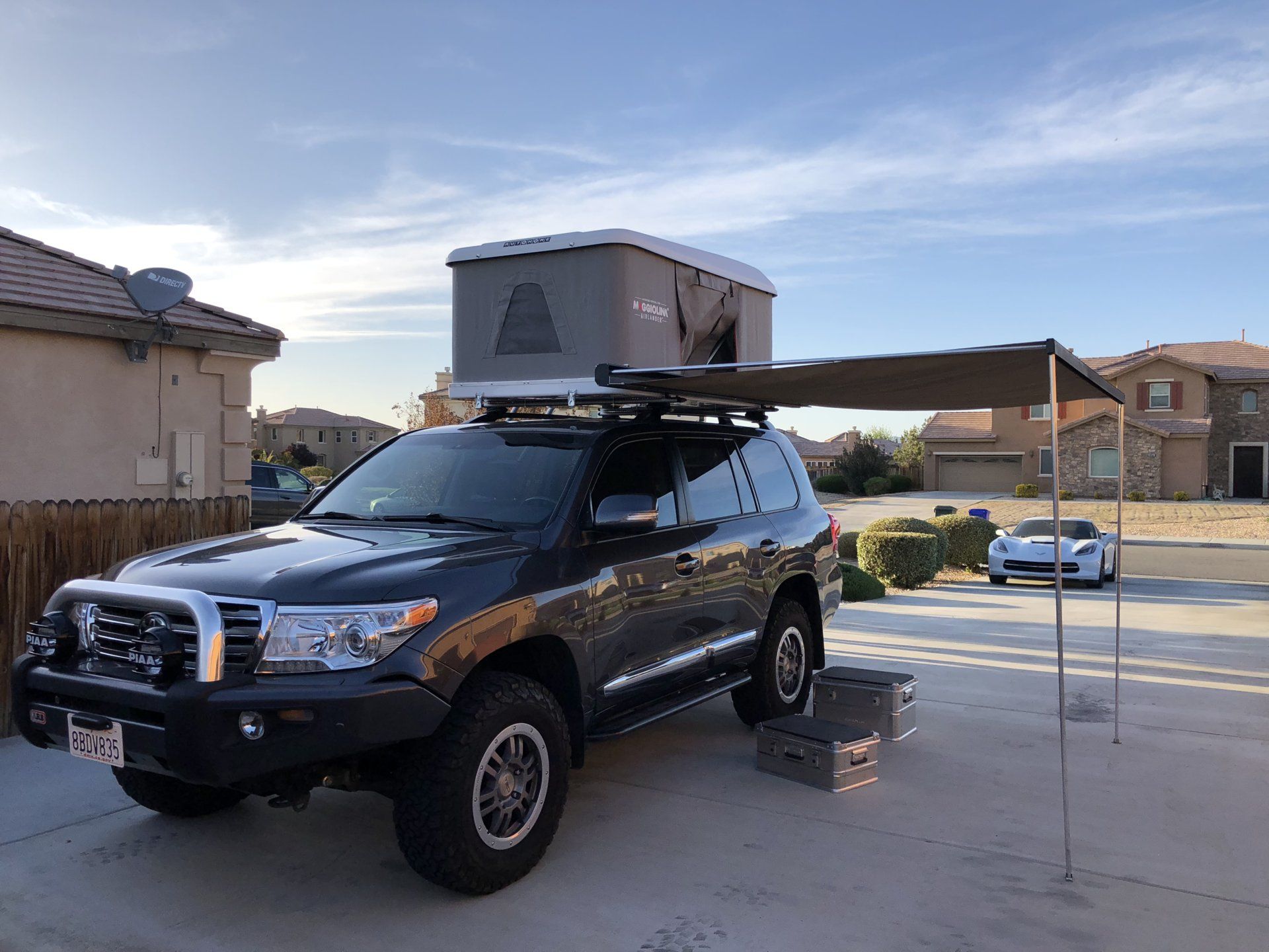

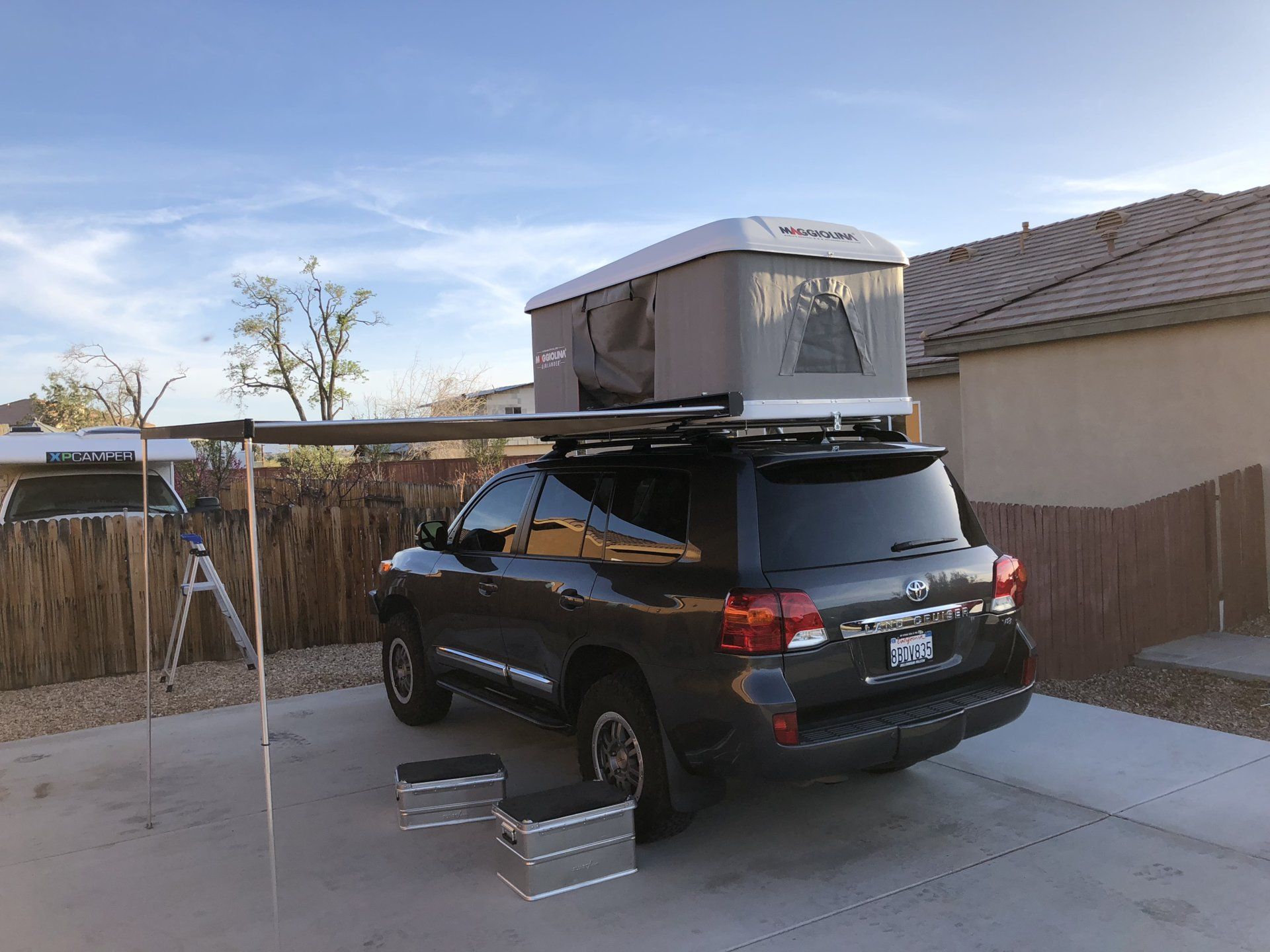

Mind sharing where you got those stainless steal boxes from?
I know someone responded but I wanted to share that mine are Alu-Box from equipt1.com, no affiliation. I’ve been very happy with them. I put Goose Gear top plates on the so I can use them as steps when necessary.
I was going to run the Alu-Boxes because they look nice, are light, and I like the Goose-Gear tops, but I snagged a few Pelican 1650's instead for less money and they are actually weather proof and will hold up to tumbles and abuse better plus they have wheels.

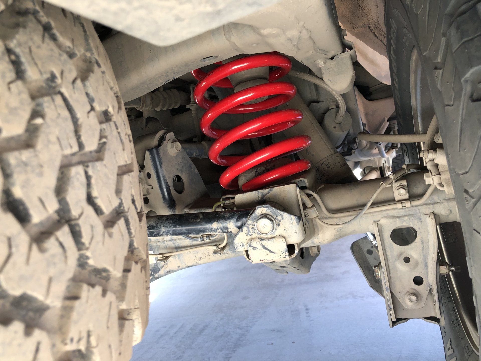

Swapped my rear springs for @TRAIL TAILOR Tourflex tapered coils, designed for a 660-1100# weight over stock. So far so good, I’m still adjusting the compression and rebound in the shocks but once I get that right, I’m going to like these. They should give me the support I need when loaded heavy for a trip but not be too firm when unloaded.

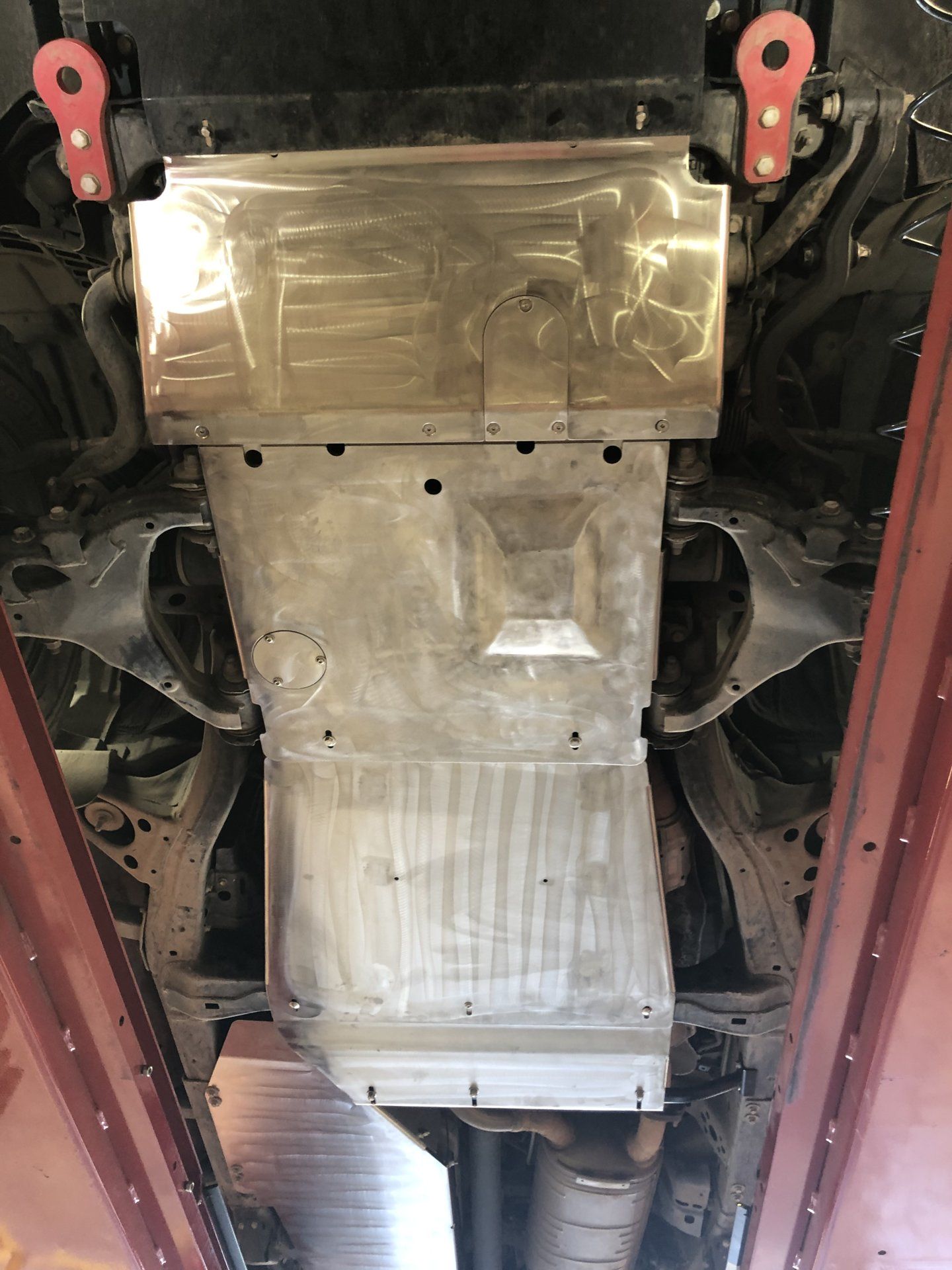

BudBuilt skid plates installed. These are 3/16” stainless steel, stage 4 rock armor. They’re super beefy. Unfortunately, they didn’t come with any instructions or even a diagram so it was a bit of a puzzle. Ultimately, after some complications my shop was able to get it put together, although they weren’t real happy in the end. I need to pick up some more carriage bolts to replace some hardware they had to use to get me back on the road. Because there were no instructions, they had install a bracket too early and the bolts had to be cut out. In the end, I’ve got a working vehicle in time to make LCDC, so I’m happy.
