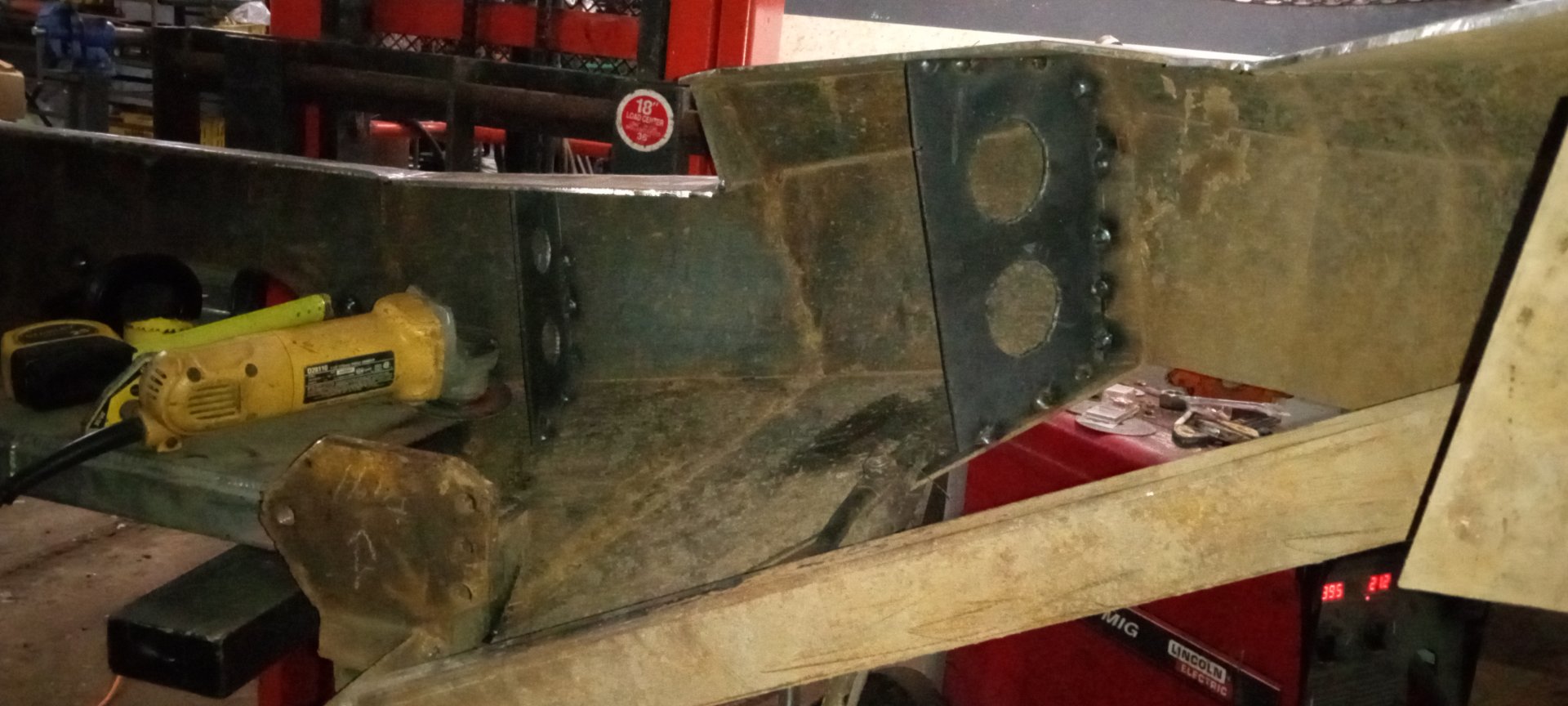

Its been more then a month so I figured I'd post an update, I finished some more bracing a while back, only got one picture...
Did some final tacking and welding, polished some lines with the grinder, and painted it truck bed liner black, changed the roller fair lead for basic black one that came with winch, mounted the turn signals, trimmed vehicle plastic using 1/4" ID rubber air hose. Alot of this process I didnt document or take pictures of. I have been super busy withn the season change and havent been very focused on taking pictures of my projects.
