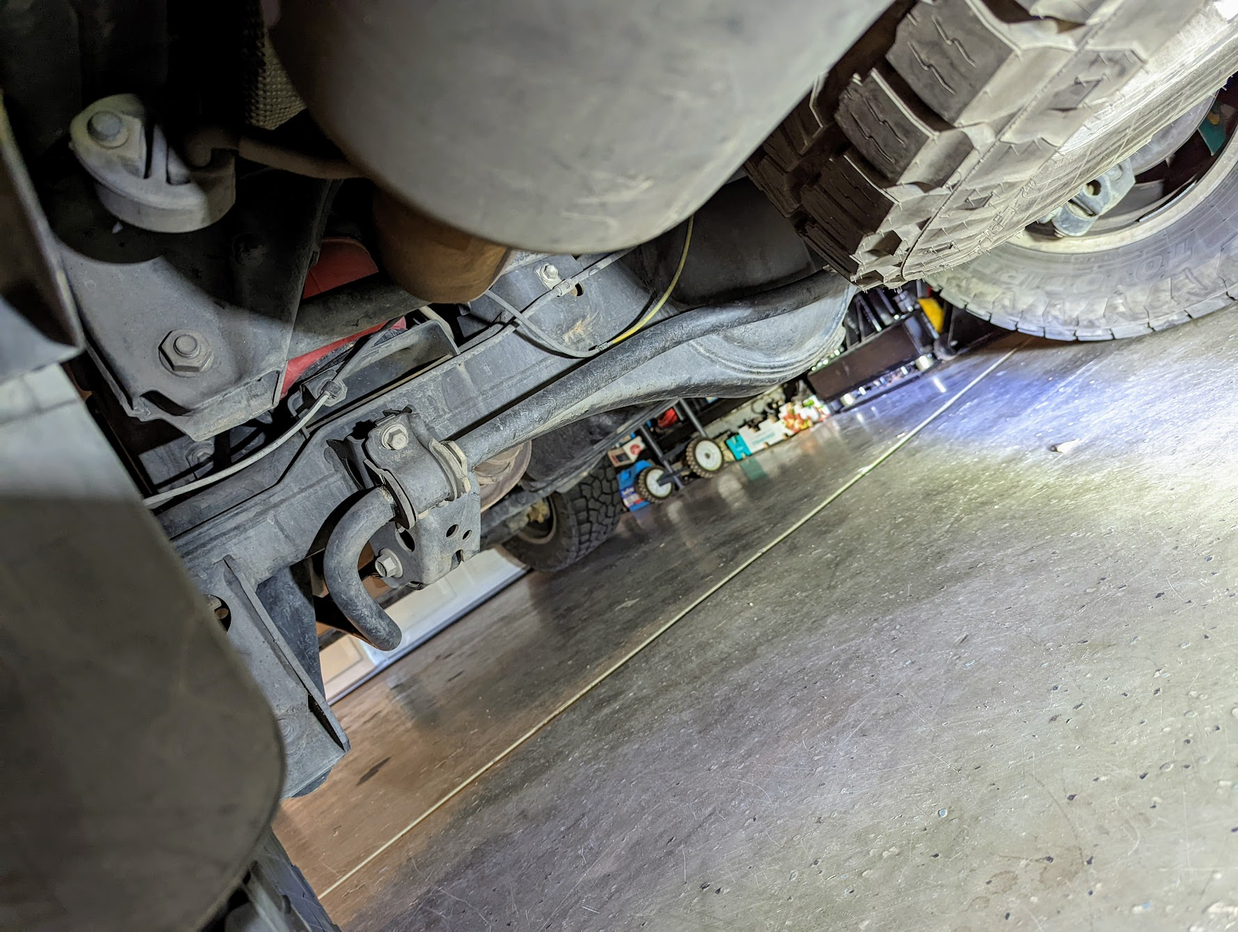

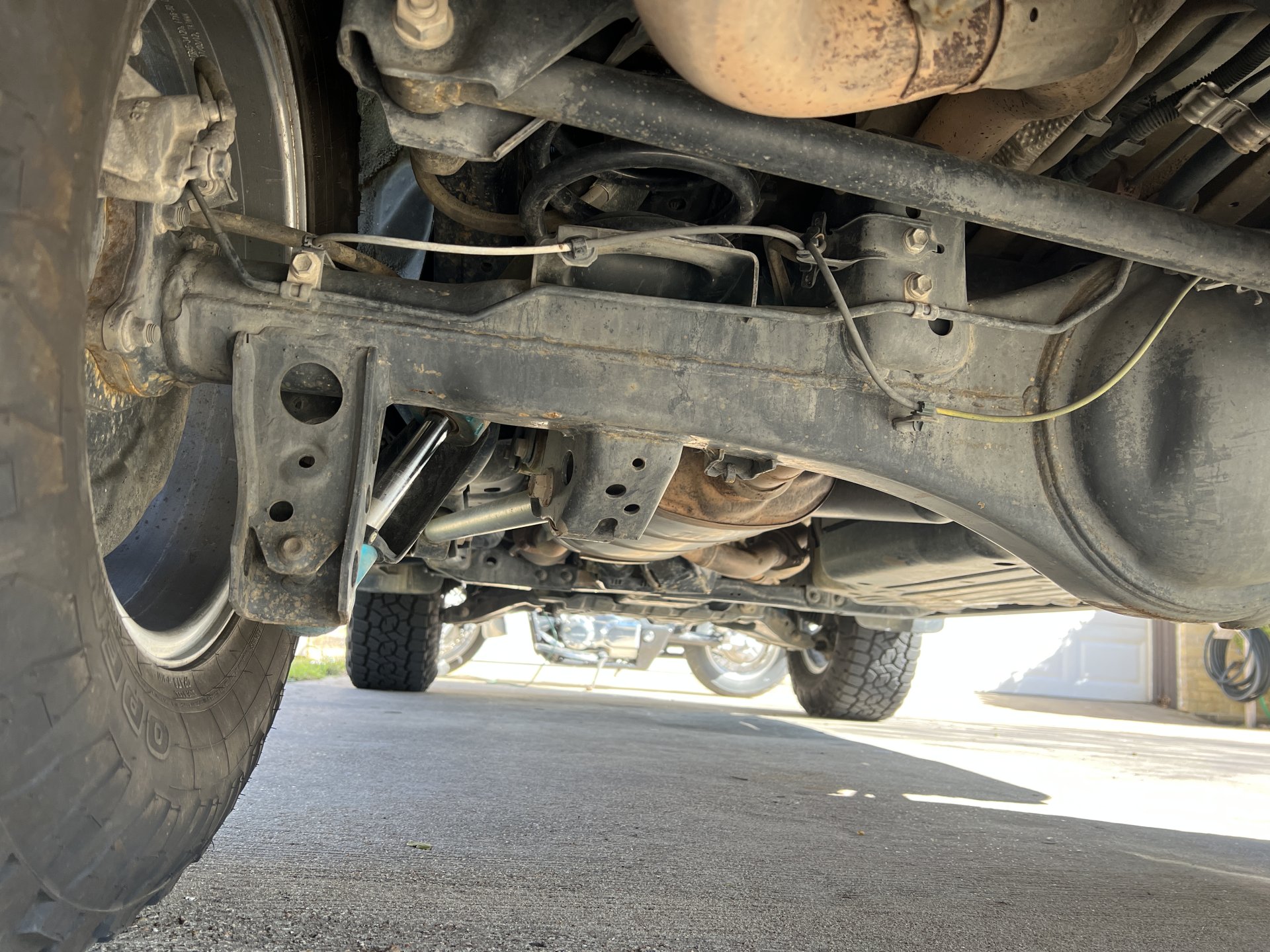

Found a random article of an AUS spec GXL LC200, that doesn't look to have KDSS. Looks like it uses the LX rear sway bar config.
If I'm staring at this right, the passenger side sway bar bracket on the axle looks to be bolt on to the panhard bracket. Which the USDM LC200 should have an interface for. So the USDM LC200 is missing the welded bracket on the driver side. In the grand scheme of things, that's not hard to add.
